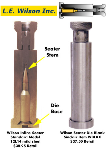

Depend if your die full supports the casing like Wilson and match die.
From pic you can see the shoulders are fully supported.
The 6.5CM and 260 have different angle shoulder.

Prefer the Wilson with mini arbor over the Forster in co-ax. Wilson give a more better feel to seating pressure, enough that with experience variations in neck tension is noticeable.
The Wilson die will seat the 6.5CM and likely chamber. How concentric is a different matter.
The Wilson is an interesting die, and using one in this instance wouldn't work.
