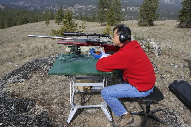

Just got in from checking out the extreme range launch site for this weekend. Decided to see if my 6.5 Mystic/139gr Lapua Scenar load would make the trip. The 6.5 Mystic is my version of the 260AI.
Had a chance to shoot it out to a GPS measured 2210m/2415yds. Despite the wind, it was very driveable. Way easier then the 223 at a 1500yds to a mile.
At 2090m/2285yds, it was surprisingly accurate. Winds were gusting up to 8mph (got a wind meter now:D) sideways and who knows what head and tail wind. So it got bounced around but not as badly as I was expecting. Could track it easily within a scope view and adj using mil dot reticle.
If the winds held constant, you could drop them into the target area quite easily. I did hit a rock that measures 20" X 20" a few times at this distance but there were alot more misses.
Not sure what the accuracy of a Garmin GPS is but assume that it is within 10m of actual. Got to dig out my WILD and compare.
I always thought that a 7mm would be a min to go these distances or at least a larger case. Apparently not. The 139gr are leaving at 2900fps and should go subsonic around 1550yds - 8 twist Gaillard pipe.

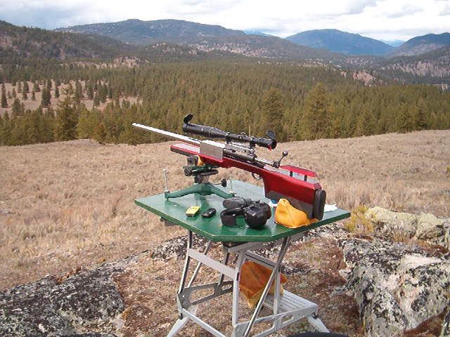

Makes for a less expensive extreme range plinker. The scope adj tasks were aided by a new adj scope base I have just put together. Second time out so lots of fiddling around to do but it does seem to work and hold zero.
Just need some calm air to really see what this rig can do.

The scope was canted for 1mile. I used full up which is double this cant. Should have taken a pic but was having too much fun lobbing lead into that pasture.

Like the new paint job. Same stock but got repainted and the comb chopped off. Will have to build a better cheek piece later as this one is a smidge small.
Good enough for now...

A little late in posting an update from the Summerland Shoot but this combo is such a hoot.
With my new mechanical scope base, I was able to gain enough elevation to reach out to 2.2km (2400yds). Hope to get somemore elevation as I have a max distance of around 2700yds.
Conditions were gusty and variable but not overly strong.
The bullet tracked wonderfully if you got the read right and the impacts were easily visible (much easier then the 80gr Amax I have been slinging).
At 2km (2200yds), the conditions were quite steady and dropping bullets in and around the target was straight forward.
At 2.2km, things were much more bumpy and tough to dope. Then I also got some large vertical which I am blaming on the wiggle in my bench. Will get back once the weather improves and shoot prone.

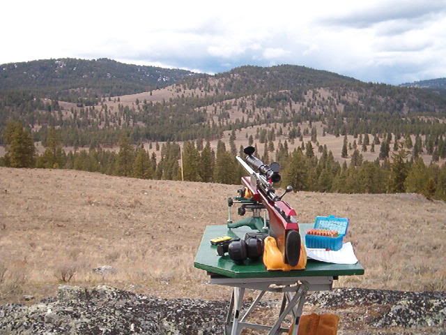

Here is a pic of the rig with the base cranked. Kind of funny looking through a 'level' scope with the barrel pointing way up. The stock cheek piece had to be raised about 1".
Given the distance, it certainly kept up with the big boomers. I was pleasantly surprised and impressed.
With the block, I can shoot ALOT before things get hot and that shooting will not put me in the poor house. Loving it...
Jerry
The barrel is not in the way. I have a clear field of view.
A longer pipe or more up and I would start to 'stare down the barrel'..
But right now, it's working just fine. Rough estimate of up is 140min. It is not linear so at the top of the travel, you move the base more for less change in elevation. The orig mechanical movement suggested 175 to 185mins of up but that has not worked out in real world shooting.
I am sure there is a math/geometrical reason for this but I can't be bothered at this point.
I will machine more adj into the base. I hope to get another 20 to 40mins of up so I can take my 6.5 over 2500yds. Maybe even out to 2700/3000yds. A scope with more elevation adj would solve this problem easily.
