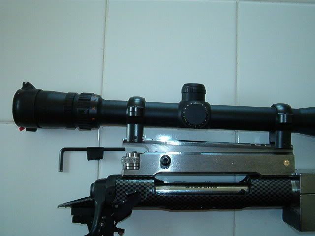

Finally got a moment to take some shots of the elevation base. This is my prototype so not well finished. But it does work and is repeatable. A few points to iron out but it is pretty much done exterior wise.
The base is drilled and mounted as a one piece scope base. If there is interest, I would consider making bases for Savage/Rem long and short actions.
Depending on the ring height, scope and barrel orientation, expect around 150 to 175mins of up.
Jerry
All the way down for your 100yd zero.

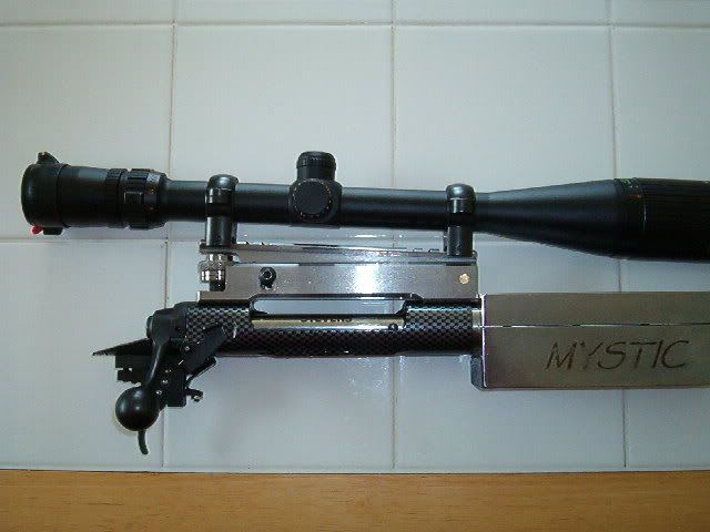

All the way up that gets my 6.5 mystic to 2200yds using base alone.
Gives you an idea of the amount of UP available. I will actually be able to put in a bit more so I can reach out to 2500+yds.
