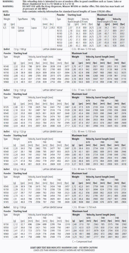

I have been reloading for my Sako 85 Finnlight. I am partial to 140 grain bullets as I think they will do the trick for large game. The Nosler manual shows that max load for RL-22 is 46.5 grains for a 140 grain bullet. I was only getting around 2510 fps or so from this load. I went up to 47 grains and velocity moved to 2540 fps. This is way lower than the manual which shows I should be getting over 2600 fps with just 46.5 grains of RL-22. I was thinking of going 47.5 grains or higher which may mean a compressed load, but the Sako has a long throat and I can seat the bullets way out. The cases so far at 47 grains of RL-22 show no excessive pressure signs. Why are all the manuals so anemic for this cartridge. I have always found that velocity is the best measure for pressure.
Anyone have any experience here?
Norm
