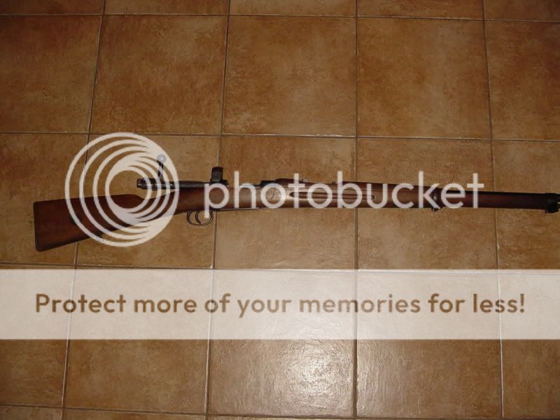

the more i check it out...the more i like it.. even though that barrel is Loooong
i'll puts some pic's up.. and i can't see just owning only one..

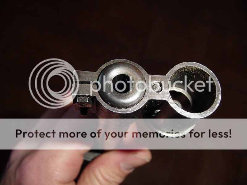

the crown was mint.. even the blue was continuous all around it.. i don't know what to say...i've never seen an old military rifle with a crown that nice.. ... total opposite of the old garand i usta own.. the GI that used it musta hammered tent pegs in with the muzzle ... it was painful to look at

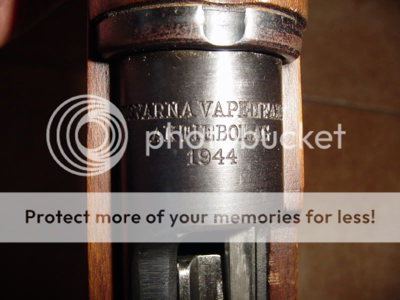

stamp on reciever

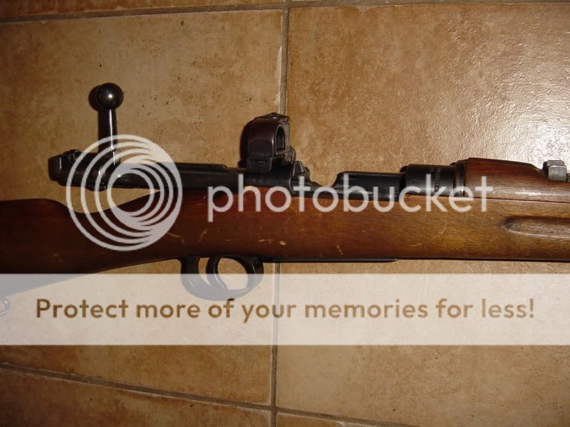

oh it has a tiny crack on side of stock... which ain't much... I know exactly how to deal with it
well... i had hoped it would be in rougher shape so i could give the stock a full resto ...and put a scope on it... but dang it... i just can't do it... its too damn sweet ... it'll stay the way it is.... maybe i'll get the original rear sight and front but that'll be it... and use it the way it is...

your Swede

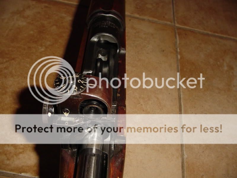

Of course it is accurate. It is one of 18,000 Husqvarna m96 rifles made for the FSR, in 1944. The FSR is the Swedish Volunteer Shooters Association. It has Soderin rear diopter sights on it, and do not worry about the supposed stock disk missing --it never was there. Also, Husqvarna held the barrel tolerances to 6.49-6.50 millimeters in these rifles.
These rifles were made for Civilian target shooters, and were not part of a Military issue. They were sold to their Swedish owners with the understanding that the rifle "could not be significantly harmed," or in other words, sporterized or Bubbadized. The addition of the Diopter sight was one approval, and a detachable pistol grip was another. The drilling of some small holes in the back of the receiver bridge was not considered harmful.
These rifles were made to Swedish Military specifications, and in case of an emergency, the government could buy them back. The two above modifications could easily be removed, and the Government had 18,000 rifles available at no cost to themselves, unless War was declared. The government also loaned some of these rifles to Gun and Shooting Clubs.
I would not worry about the crown of the barrel, as long as it shoots well. A good, well tuned m96 rifle will keep up with a CG-63 rifle on the range.
The sights should go up to 600 meters, as this is what the Swedes use for their "field shooting" matches. The domed range ring on top can be replaced by other range rings. There are three of them, for different types of ammunition, and are colour coded --white, yellow, and red----for 160 grain, 139 grain, and Norma Match ammo. If you reload, you might have to zero the rear sight, and a special tool is needed to do this, but they are available on E-Bay.
