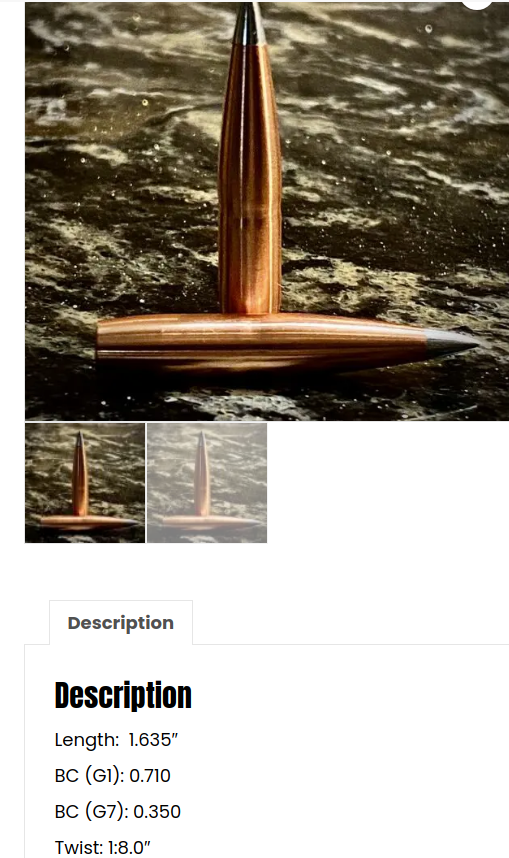

BadLands Precision is shipping a 150 grain.710 bc bullet for the 6.8 that should be interesting
More people are taking a second look at the 6.8.
