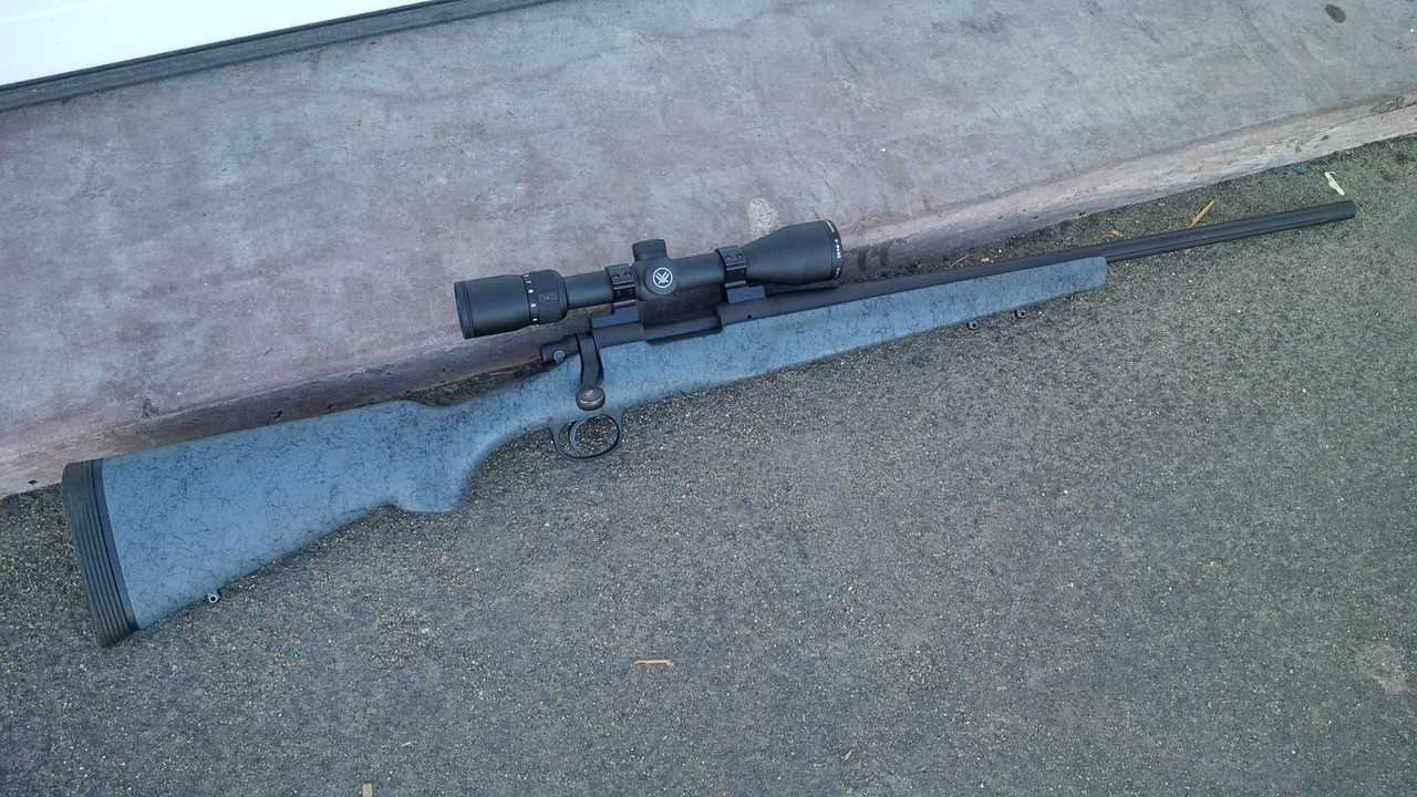

Rem 700 not the best picture but...
Rem 700 LTR before I swapped stocks and scope

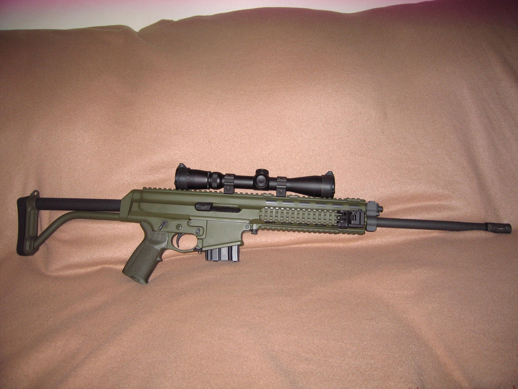

XCR-L before I swapped to a FAST folding stock
