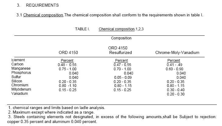

And here is the US Gov standard MIL-B-11595E listing the three acceptable alloys for making M16 barrels.
I haven't asked the NEA engineers, but I'm guessing they are using ORD4150 as there would be little benefit to resulferize it prior to ferritic or nitro-carb surface treatment. YMMV. You typically resulferize to make a barrel easier to machine (i.e. a free-machining steel). When doing non-chrome surface treatments you are better off biting the bullet on tool wear and using non-resulferized alloys in my opinion.

As for barrel material, "4150 Chromalloy Steel" is a pretty general description that does not equate to "11595E Certified" barrel steel, and I was looking for further information. I am in the market for two new barrels, and the NEA barrels are a possibility, provided they tick off all the right boxes.
