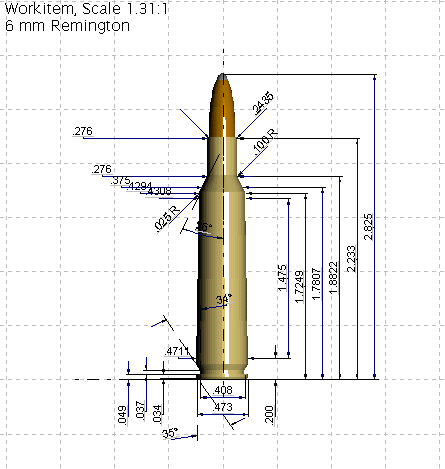

No it will not!!!!!! The 6BR is much shorter at 1.55" total case length, while the neck shoulder junction alone on the 6 Rem is 1.88" so the BR neck will not even be touched.
