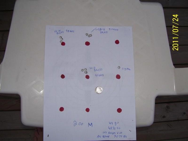

Just got back from the range and had some good results this was shot at 200m of the bench not much wind and very hot.
I haven't gotten the speed up to where I would like but the groups are looking good and it seems to be pretty consistent.
Today I tried win and lapua brass both group well but the lapua seams to show a bit less vertical.

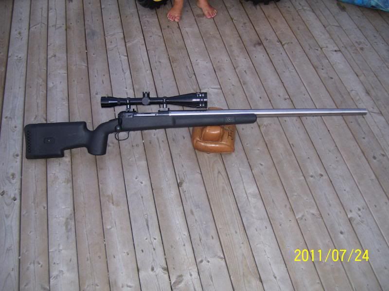

I guess from the picture you can tell it is a stevens 200 sitting in a chote stock the barrel is a gaillard 28" HV and I need a good trigger.
Overal I am happy with this rig and it is showing to be an accurate round that is a dime on the targett ,sometime this week I will push it to 600m and see what the verdict is.

I think it will shoot good out at 600 judging from what it does at 200 , my 6br doesn't group any better and I've shot some 2-2 1/2" groups at 600 I expect at least the same .
The bullets I was testing are the same I shoot out of my 6br at over 200 fps faster it will be interesting to see what comes of this.
So far it has shot well with all the loads I tried it seems to like anything not fussy at all.
It shot good with both 105's and 90's none of the groups have been over 3/8 with anything I tried, even when the load was being worked up the groups stayed the same.
