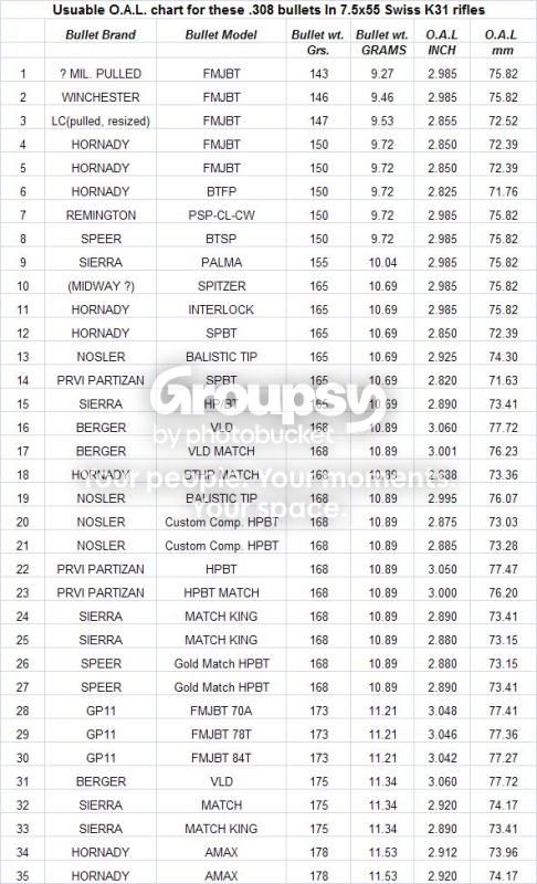

I broke my press full length resizing 7.5 swiss brass fired from my K31. Next thing on my list is to buy a neck sizing die! The brass was Privi nny headstamp.
I learned this the hard way. COL and projectile shape is really important. The 150 grain slugs have a different ogive than the 180's. Make sure to check that the reload fits the chamber before making 200 of them...Doh!(((Echo))) said:...Watch your COL's...

To the OP, sorry I have no idea what dies and such you'll need. Good luck on your search and remember, Win .284 brass can be resized if you can't find 7.5x55mm and K31's have a short throat. Watch your COL's.
