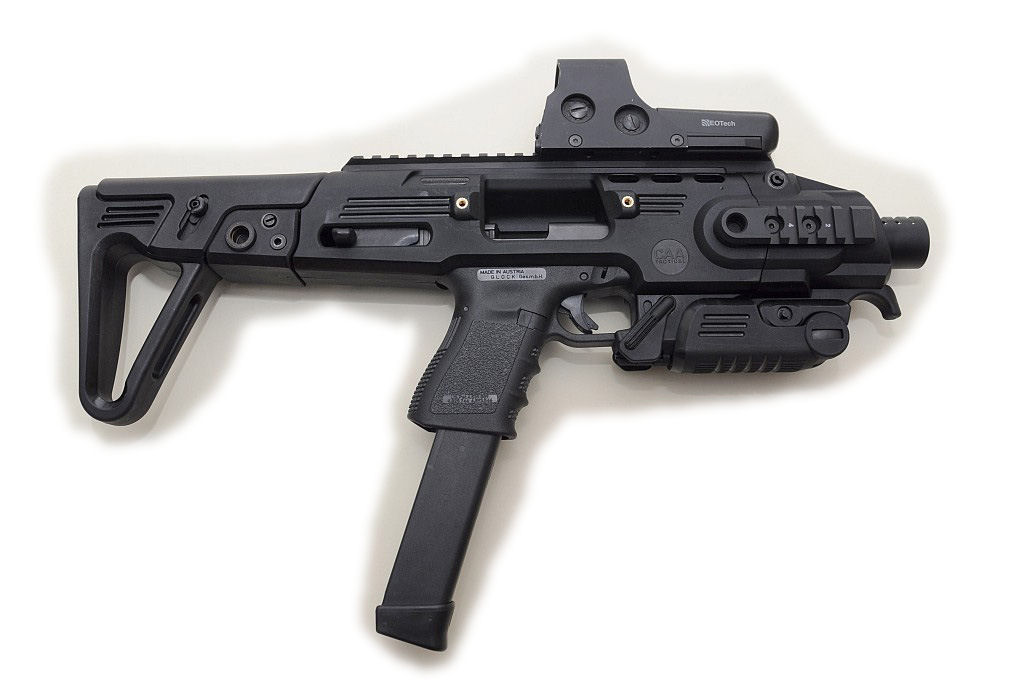

What about someone just making up a fabricated mould that would overlay over a TT33 or M57 pistol that fit along the lines of products like this
If someone was artistic they could make up one fine mad max style mould to go over those style of pistols. If they work on Glocks, Sigs and Berettas why not some Tokarev's
