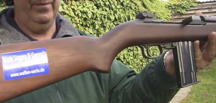

Creation From Herbert “The Mad Gunsmith” M1 carbine in 7.62x25
the cong beat him to it many many years ago. when I was a much yonger man lever brought a bunch of carbines and 1911s in from " over there" someplace, and in the bunch there was one carbine and one 1911 that had been converted to the tok round very very crudely. I bought the 1911 but he would not sell the M1 at the time.
