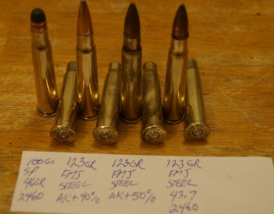

Mini range report: Since I’m not a retired guy, my opportunities to shoot are limited. Today was Sunday and expected to be the warmest day in the next week, so I decide to drive the hour it takes to get to my range, in a blizzard. Once there, it was minus 10 with falling snow and shifting winds. Everything was unplowed and it was no surprise that I had the place to myself.
My goal was to put maybe four or five rounds of each of my loads downrange – mostly to see if I was on the right track to be able to cook-up a load for my 303 British, made from pulling down Russian surplus AK ammo, that would group as well as my commercial powder reference load. The reference load I was trying to match was made-up of 123 Gr FMJ steel core bullets (from surplus Russian AK ammo) pushed out of 303 British cases by 43.7 grains of AA2460.
The goal was really to reach a point where I could match this load with another, made-up of donor AK powder – so that the two loads had the same point of impact, and grouped the same. If I could find the right formula for a load, motivated by pulled down AK powder – that matched my 123 gr/ AA2460 load then, I’d be in a good place. This is because I’d be able to use the “free” powder from AK rounds in my 303 until the pull down powder supply ran-out – but I’d have remaining 123 grain steel core pills – that I could then load-up with AA2460.
Given the crappy weather – and the fact that I was shooting with cold hands on a blustery day … and all that I didn't expect to get to pull down Nirvana. However, things went “good”.
First of all, my reference – load made-up of pulled down AK pills, pushed by 43.7 grains of AA2460 shot 4” groups with no drama – and the ammo cycled well in my semi auto Mohawk; throwing case about 4-5 feet. Then, I tried a load using the same AK donor pills and 1.4 times the original load of AK powder. The Mohawk cycled gun more gently – and sometimes lacked enough energy to lock the action open on the last round. If anything, this AK powder-motivated load shot better than my reference AA2460 load – with a 2.5-inch group and a slight flyer taking the overall group to sub 4”.
The next test load was AK powder times 1.5. Bingo. Another 4” group and the gun locked open on the last round. I got basically the same point of impact with the AA2460 load and the AK times 1.4 and AK times 1.5 loads. Even with AK time 1.5, I wasn’t seeing any signs of pressure – and that load didn’t eject cases as far as the AA2460 reference load. I’d bet that AK times 1.55 would get my commercial powder and AK pull down powder loads producing matching results.
Just for fun, I also tried some NOS 32-20 pills – more specifically 100 gr Remington SP .311 projectiles loaded into 303 British cases, motivated by 46 grains of AA2460. They were shot in a L-E, so I don’t know if they would have cycled the Mohawk, with its current gas settings. The point of impact of these was basically the same as the loads noted above. However, even out of my super-accurate custom No.4, these commercial SP 100 grainers only showed a 10+ inch group. Too bad. I paid $50-$80 to buy 1,300 of these. I guess I’ll try those little 100 grainers next in a 7.62x39 gun.
The bottom line is you can make accurate 303 British reloaded ammo from Russian 7.62x39 surplus ammo and, when the donor AK powder supply runs out – and you still have pull down projectiles left over, just switch to AA2460 and you can have a matching load with that stuff.
