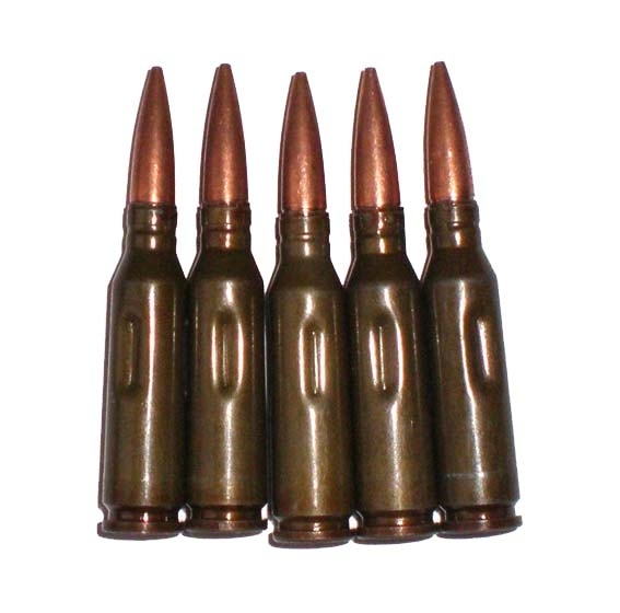

I've recently been to Russia and you can buy official Soviet training rounds there on flea markets.
They have three grooves stamped into the cartridge to tell them apart from real ones:
They cost one dollar a piece there. Unfortunately, the airport security would not allow you to carry what they call "munitions" even in check-in luggage.
