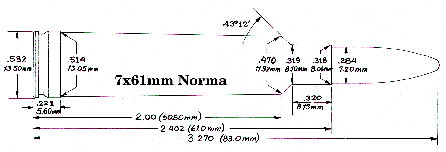

I'm really late to this thread, but I'm interested in the 7x61 S&H round in the Schultz & Larsen rifles. For those of you who have handloaded for your 7x61 S&Ls, do your rifles have freebore? If so, any idea of how long it is? (Maybe .25" or so.)
Some old data. Might be useful.
