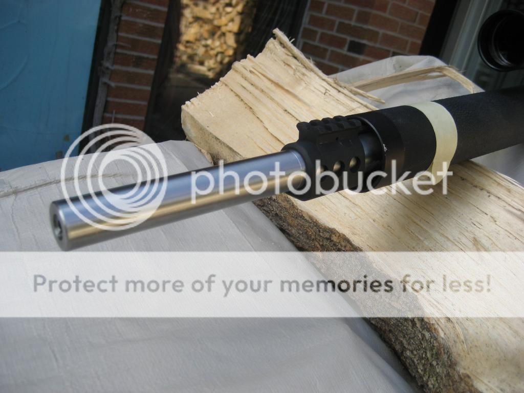

The rifle has a very heavy 20" 1:7 SS barrel.

Here is a picture of the heavy rifle. The fact that the Noslers fail to perform in 4 rifles suggest that it is not a barrel/scope problem with this rifle. I am about to install a 20X scope for some serious load development.
