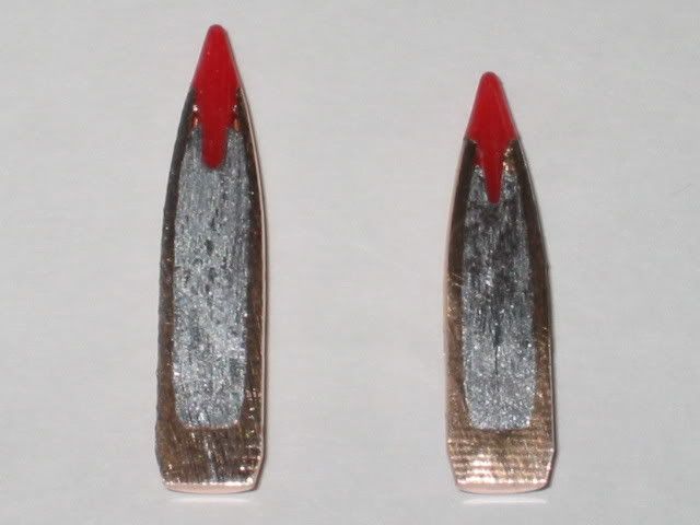

The Ballistic Tip is a cup and core bullet. The 120gr 7mm Ballistic Tip is actually tougher than the 140gr version, because the jacket is not as thin at the tip, the 120gr bullet was built tougher for silhouette shooters. I have killed a few deer with the 120gr Ballistic Tip, and it performed very well.

It's possible that the Accubond was developed from the Ballistic Tip design, but the Accubond had a bonded core so it's a fundamentally different bullet than the BT (which is a traditional, non-bonded core). BT's and Accubonds are not the same bullet.
... The 120gr 7mm Ballistic Tip is actually tougher than the 140gr version, because the jacket is not as thin at the tip, the 120gr bullet was built tougher for silhouette shooters...
Very interesting info!
It's amazing what you can find when you poke around the internet for an entire, large mug of coffee.
stubblejumper... adding your search word "silhouette" led me to this little gem of a photo. It appears the 120gr. BT was created simply by shortening the jacket on the 140gr. from the front end, which means the thinner part of the jacket was trimmed. As a result, the 120gr jacket is thicker thus making it a tougher bullet than the 140's. This defies most peoples' logic, in that some fellas have driven the 140's pretty fast and experienced blow-ups on bone, which would make anyone think heavier is better and the lighter 120gr must be worse/meant as a varmint bullet. When in fact, field results show the reverse is true. Anyway... a pic is worth 1,000 words. 140gr. BT on the left and the 120gr. on the right.
I'll echo stubblejumper. From John Barsness writings - the 7mm 120 Ballistic Tip was "toughened up" because it was so popular with silhouette shooters, so earlier ones will have much lighter jackets, than later ones. Unfortunately I can not find the "cut off" date when the switch over occurred in Nosler production, nor do I know if the part number was changed. I have a few of the older "red boxes", which were called "Nosler Solid Base" P/N 30343 (probably a predecessor of the Ballistic Tip), and some Nosler Ballistic Tip Hunting P/N 28120. No clue if these BT Hunting are the "tough" ones or not? I have shot at least a dozen deer with 7x57, but was using 150 grain Partitions. They worked. Was thinking to use the 120's on paper targets or coyote sized game.
