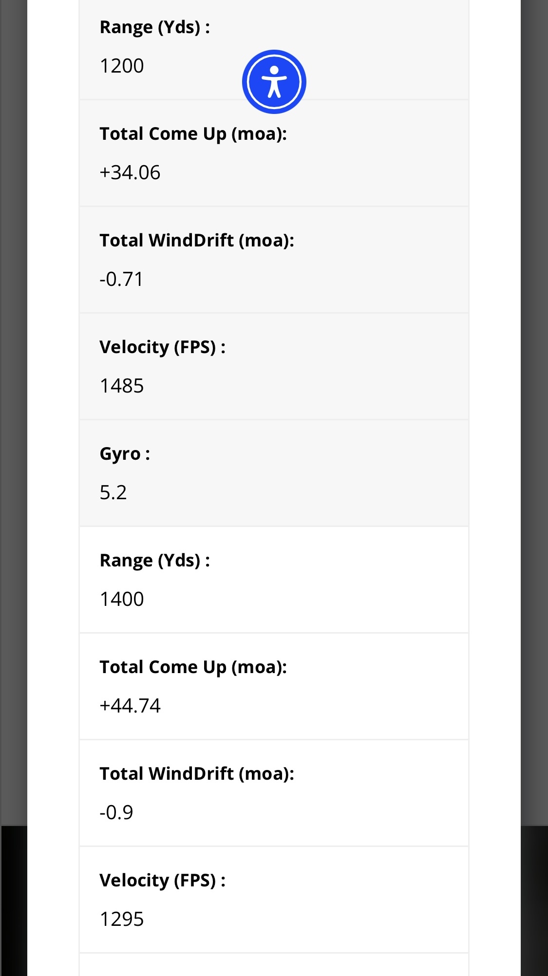

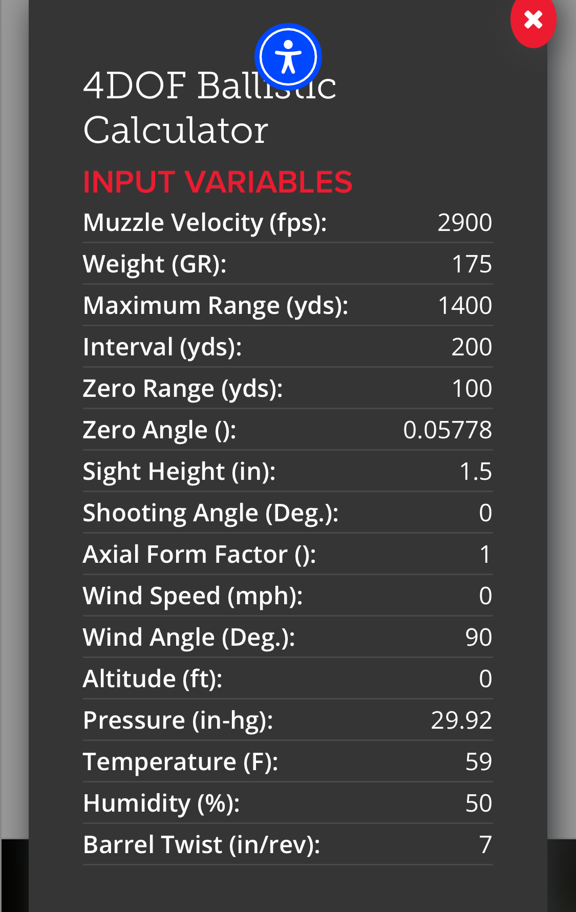

Here’s a simple calculation using the 175eldx going 2900fps. The 7saum built on a long or medium action with a long throat should be able to push that with a 24” barrel. Longer barrel or prc will be this fast or faster, but you won’t know for sure u til it’s together. A 20moa rail and a scope with enough vertical adjustment will get you to 1400yards and still supersonic and that’s a hunting bullet. I think you can do it with an 8-10 pound bare rifle with a nice break and it shouldn’t beat you up too bad lugging it around or managing the recoil.
