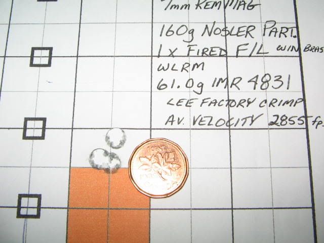

Here is a 3 shot group using 160g Nosler partitions and IMR 4831.
I have gone as high as 63 grains of IMR 4831 with the 160 partition and accuracy was about the same.
I have also used RL-25 with great results.Both with 160 and 175 Nosler partitions.
