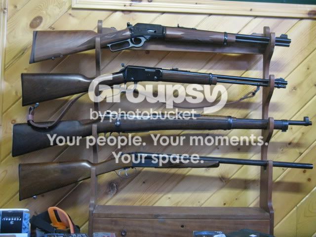

Heres the obligatory pic of it in its original form. With some of its straight stocked stablemates.
