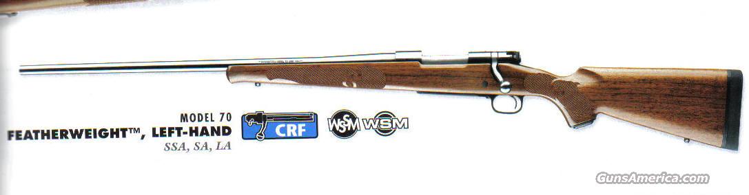

I would like to find this rifle in 7mm WSM as a new carry rifle. My Model 700 in 300 RUM is a bit heavy with it's laminated stock. I like the 700 as a blind rifle with it's reach. But the 7mm WSM reaches out well too and the featherweight is not only the prettiest rifle ever made but a fast handling bush/still hunting rifle.
