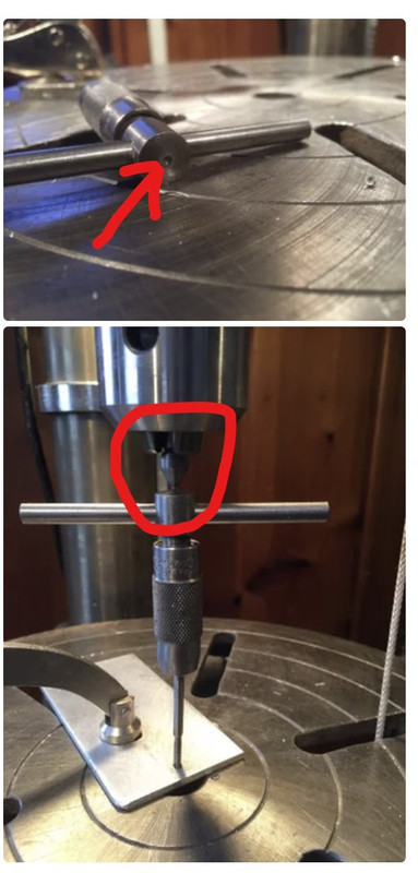

If you can set your item flat and level on the drill press plate and putting the tap in the chuck isn't such
a horrible way to start a tap straight iff'in you turn the chuck by hand.
Gitter started straight and they do the twisty in'owt thing with lewb.
True. Helps with getting them started straight. - dan
