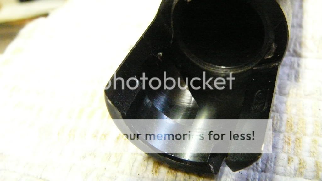

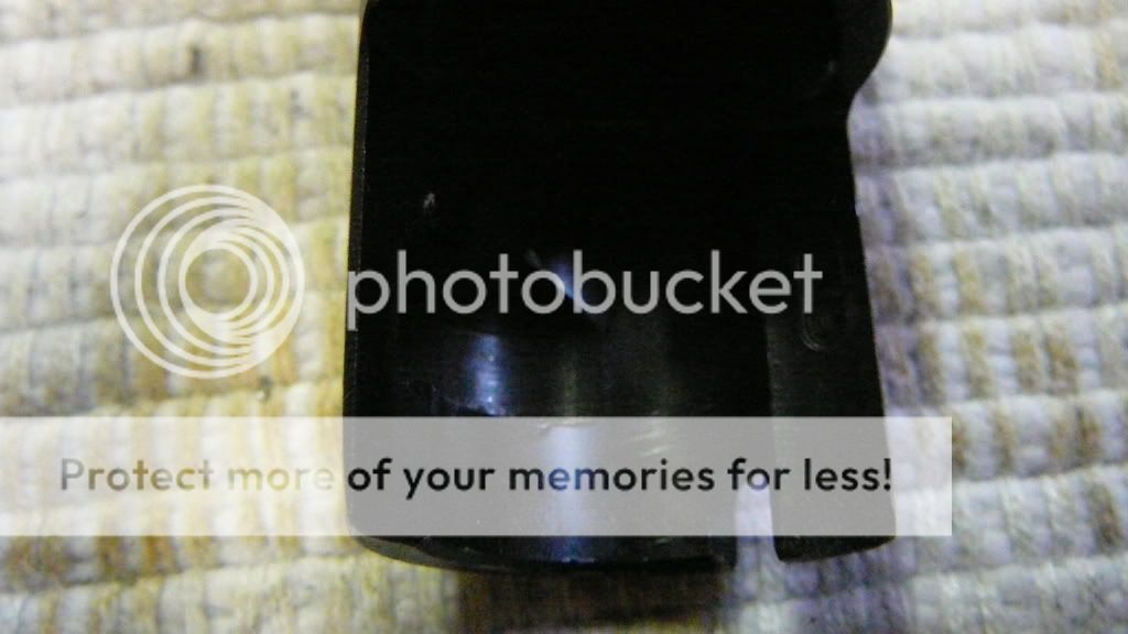

Barrel was on there tight. Everything is clean.There was something that did get my attention though. Where the locking block locks up to the barrel and on the face of the chamber, the metal is starting to peen over. You can really see it on the back/reciever end of the barrel. This is after 50rds throught the gun.:( Should I be worried about this? Should I be thinking about packing the whole thing up and sending it back?
I don't think 50 rounds should cause that kind of peening already. Something isn't right. I run an 870 wingmaster magnum for 20 years and after about 8000 rounds of hunting and clays it looked like your pics. I would take it back or at least get a gunsmiths opinion. They must be cheaping out on the new Remingtons. The old ones would cycle anything,even mud and dirt in the goose pits. If you have a good dealer he should accomodate you...ST...
I had the same problem with my 870 3" express jamming up with the cheap aluminum head winchester shells (cycled others fine). My uncle and I just polished the chamber with using 000 steel wool, metal polish, chamber brush/rod and a drill. This process took like 5 min.The chamber is like glass, and now it will function flawlessly with whatever I feed it.

Kinda what I figured. I bought it from one of the site sponsors(Epp's) Ive spoken with them about the jamming and they said they would polish the chamber no problem. I just noticed the peening tonight when I took it appart. I was going to polish it myself but after noticing this Im thinking no. I'll have to give em a call tomorrow.
