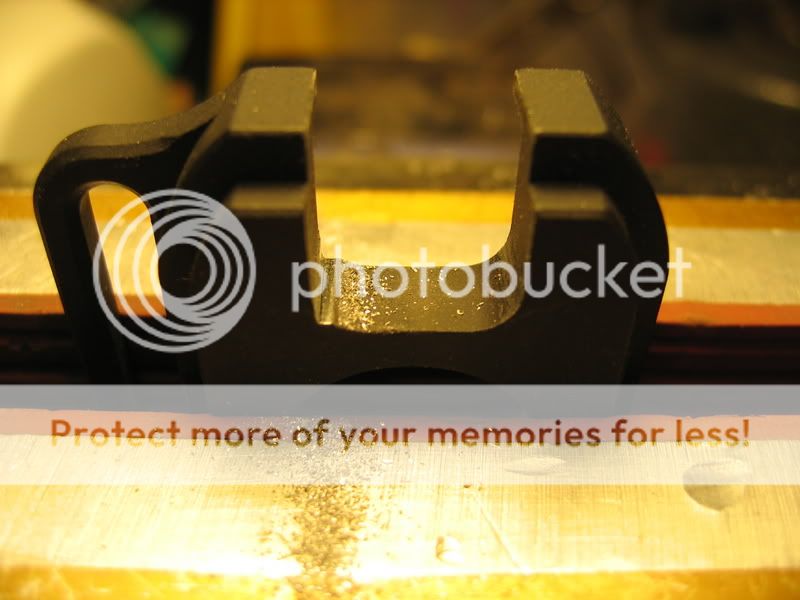

I've been thinking about this for a while but finally got around to it....
Instead of reshaping a 12 g. 870 stock to fit the smaller 20g. receiver of the 7600/7615, why not use a sling loop as the adaptor!

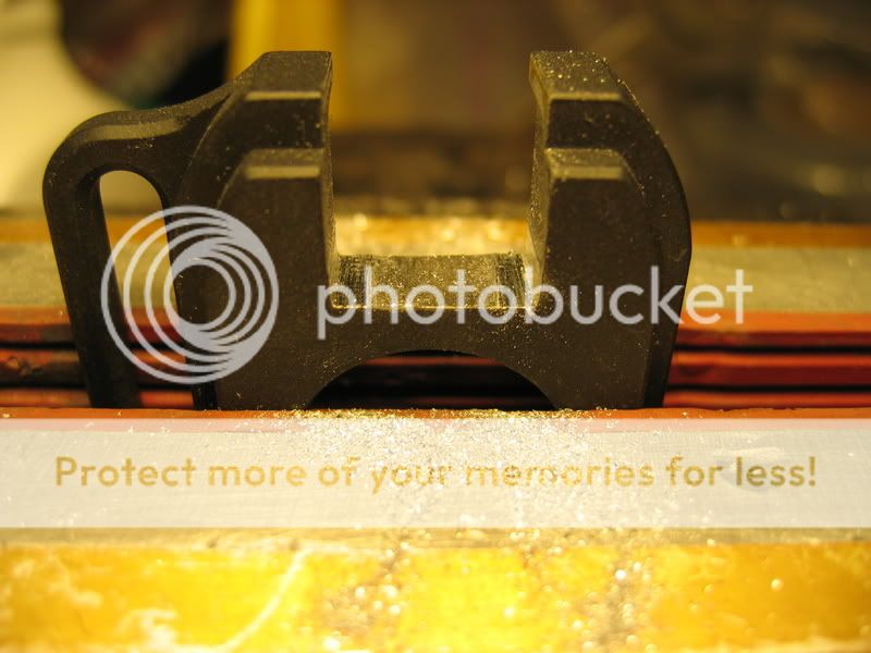

First I had to reshape the rounded part that fit around the back of the trigger gaurd to a more square shape.
Then I reduced the male side of the sling loop to match the smaller 20g. receiver.
After a bit of hand tuning with the file I ended up with a pretty good fit.

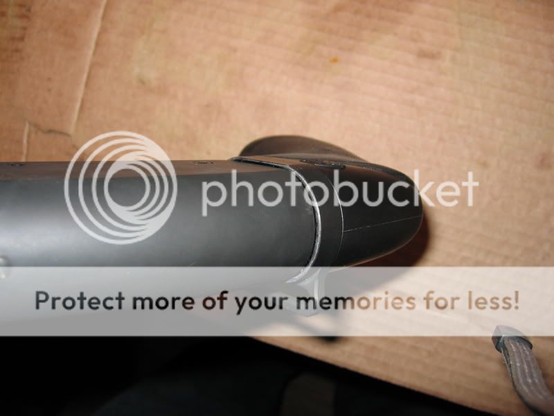

In this picture you can see the size difference between the 870 and 7600 receivers.
Wide angle:)
The total overall length is about 28 1/4" with the pachmayer grip.

The fit getting loose shouldn't be a problem as I tapered the the insert to match the taper of the receiver and it's a snug fit.
The anodized layer is quite hard and I actually used a hack saw blade to break through it and rough cut some of the material to speed up the filling.
Once through the anodized layer the alluminium is soft and easy to work.
