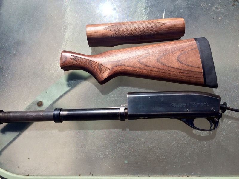

Thanks for all the info gang. I'll source a 3" barrel through the EE or buy a new one if I need to. I added a pic to the original post for those curious folks.
