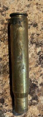

I decided to take my old 98 "sporter" out today. I have a supply of handloads, some with cast bullets, some with soft nose, some fmj, various powders. I fired some off that had cast bullets, brass cases. Powders used were AmmoMart 47SB and H4350. One round I felt some crap hit my forehead. The case was seriously cracked. There was no loud report, nor excessive recoil. My guess is that the brass was way too brittle to withstand the load.
Brand of brass? Age

In your first photo [the blue UV?] what is the pile of brown dust?
Maybe pull some of your un-fired rounds down to see if there is deterioration.
that is exactly where the case thins out after multiple firings, best to always check with a sharp pick before reloading and use caution to not over bump your headspace when resizing.
kjohn, that looks exactly like some of the "squib" load cartridges we played with back in the day.

The rifle came through the whole experiment looking just as good as when we started, however the cartridge cases, which were just over 20 years old at the time and about as factory fresh as was possible at the time, looked just like those in your pics when the charges started to get to the detonation point.
We never did get one to be much worse than those in your pics, because the powder charges got too small to ignite reliably.

Yes - brittle brass. Had that round been loaded several years ago? Powder that has gone bad within a cartridge can ruin the brass with which it is in contact.
