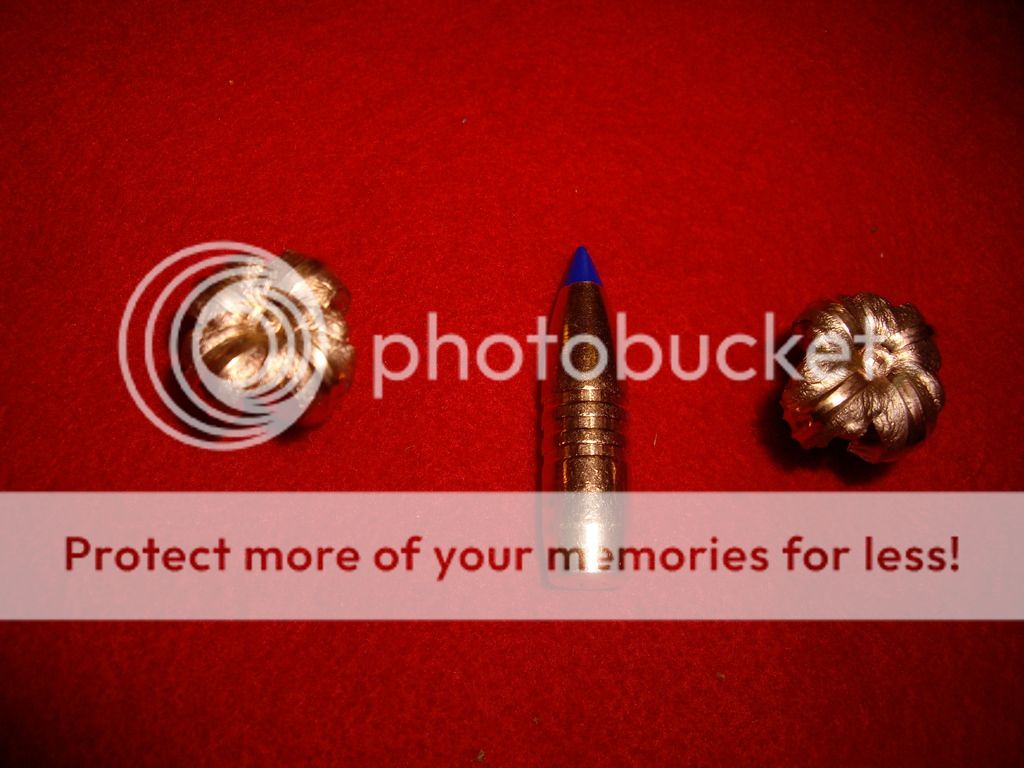

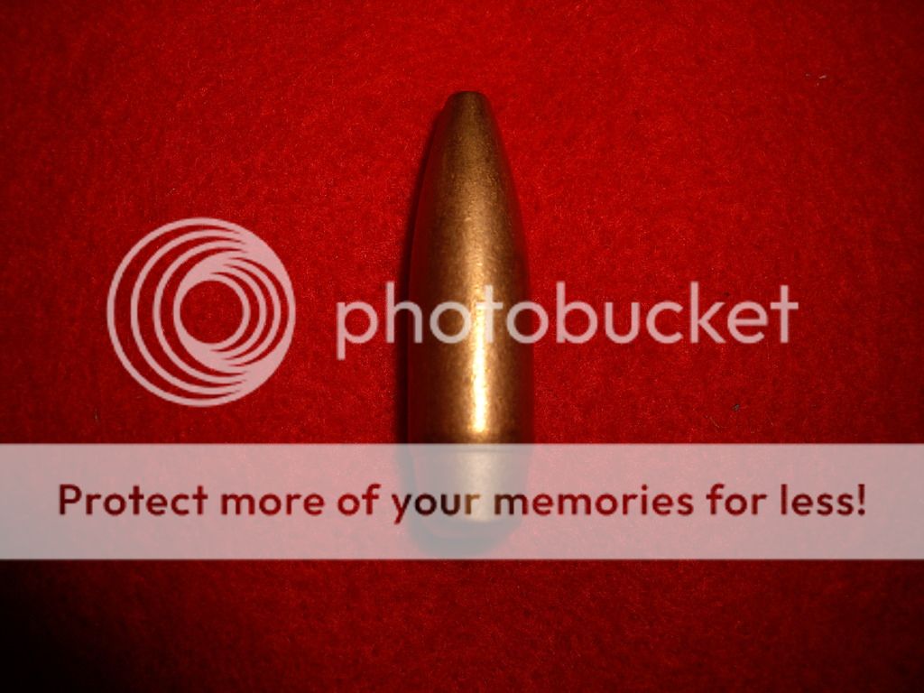

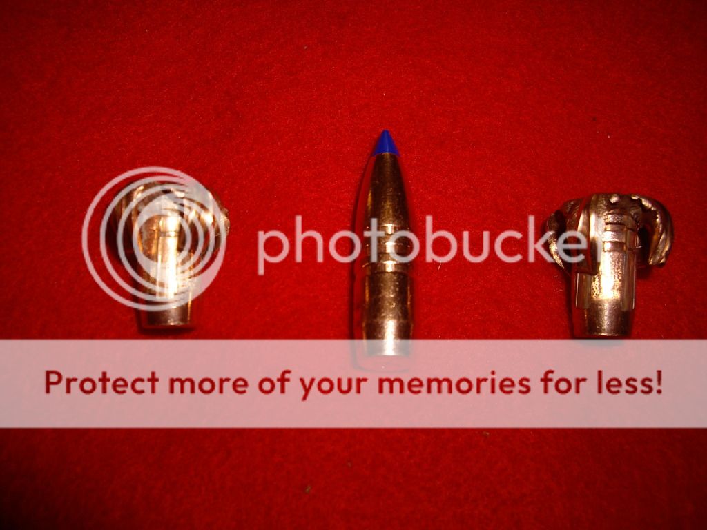

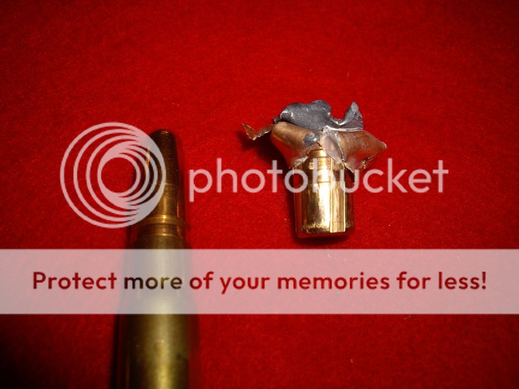

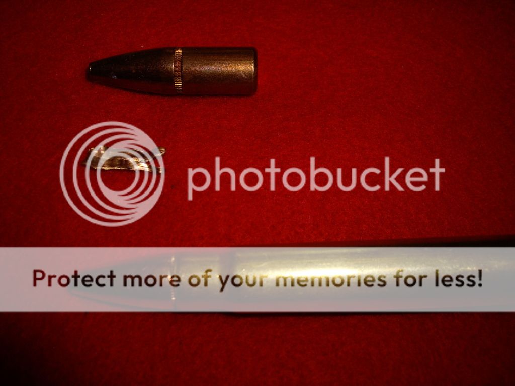

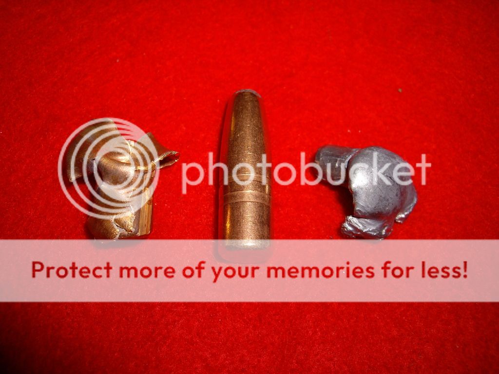

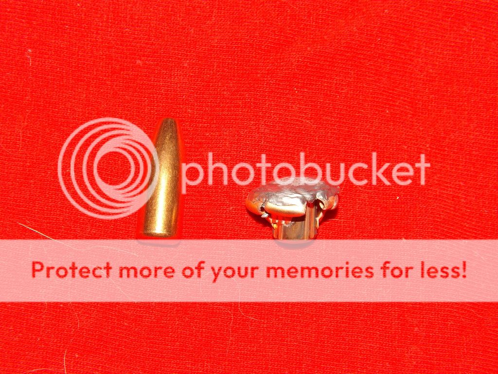

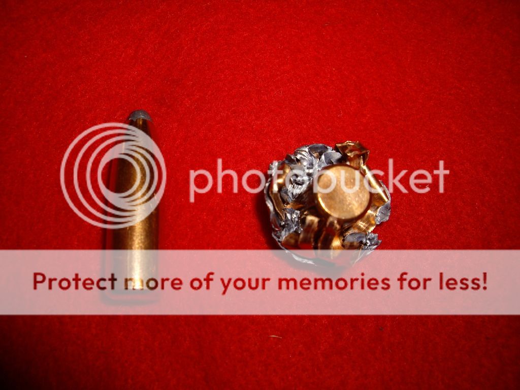

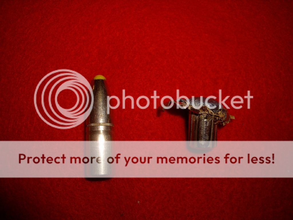

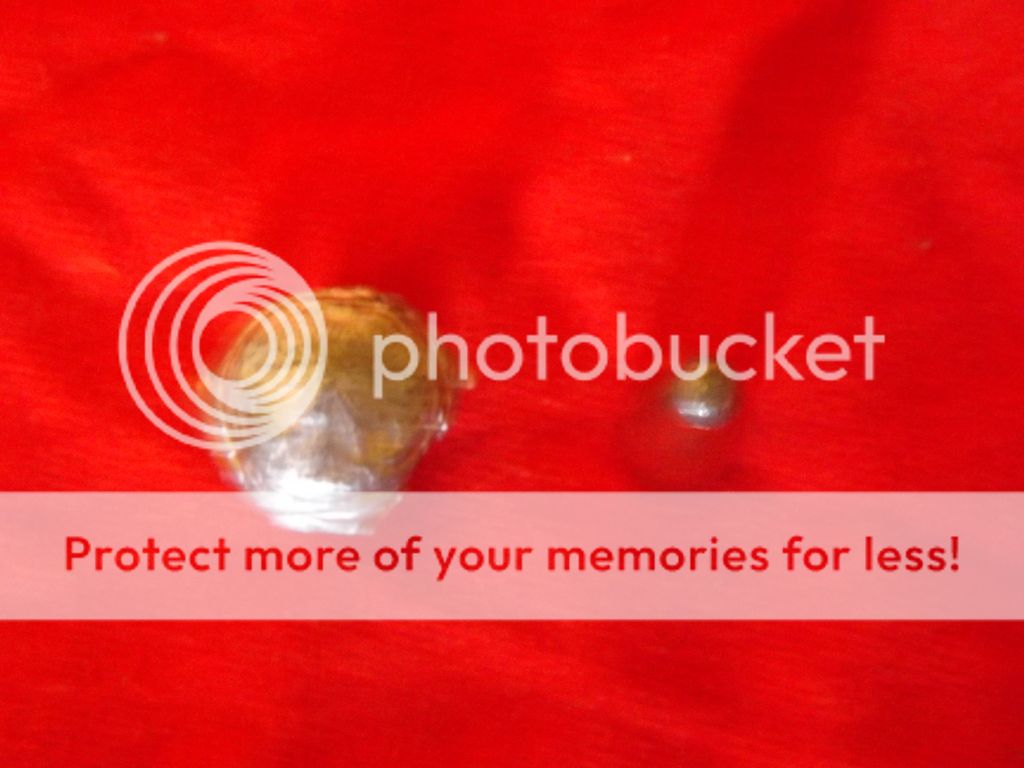

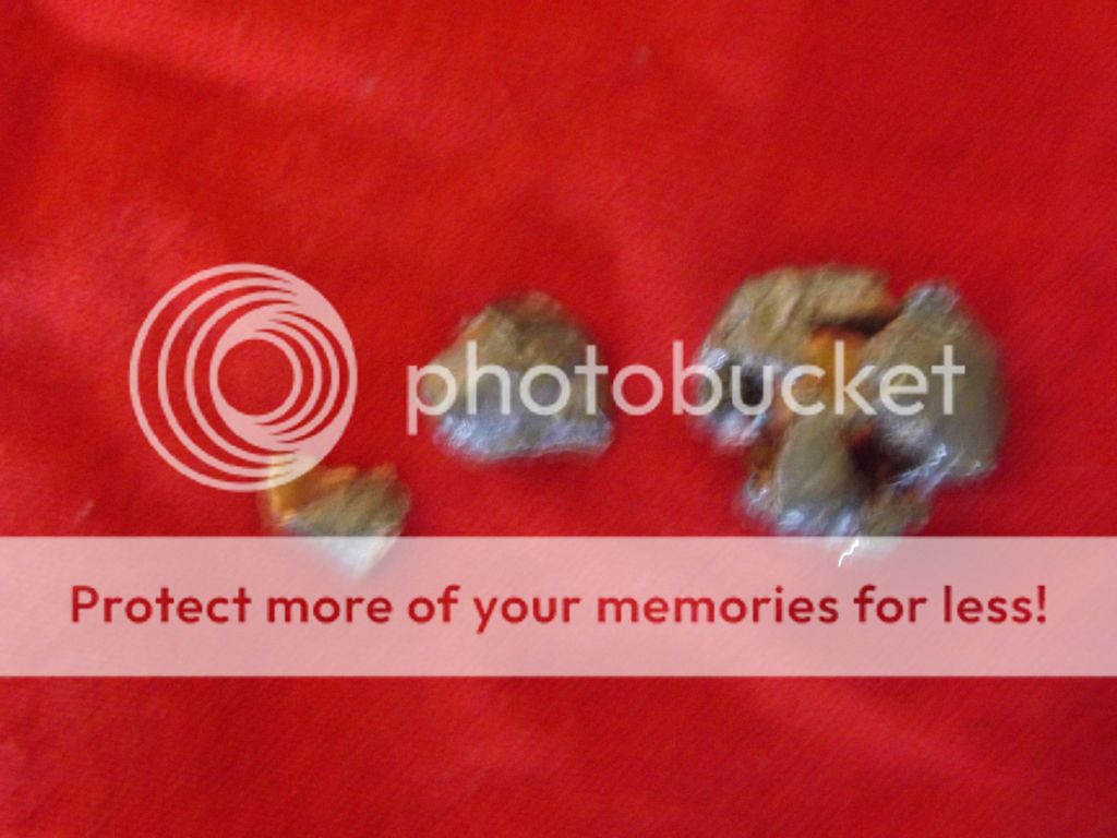

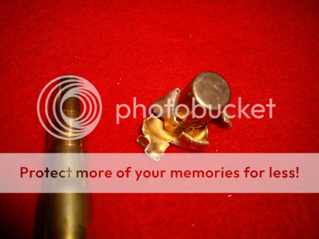

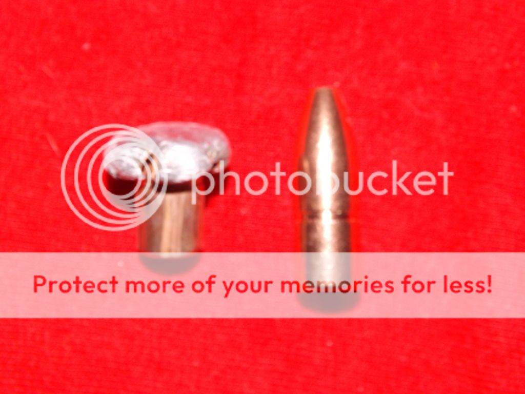

1. 231gr Norma same as vulkan
2. 232gr Vulkan found in the 5th jug 190.8 grains
3. 235gr Rhino solid-shank bullets found in the 6th jug 234.8 grains
4. 232gr Woodleigh ppsn exited after 7th jug, 2nd shot exited after 5th jug, 3 rd shot exited after 4th jug 3 shots none stayed inside
5. 247gr RWS KS found bullet against the 6th 187.6 grains
6. 250gr Accubond exited after 4 shot, exited after 4th shot for the second shot, again exited after the 4th jugs for the 3rd shot
7. 250gr ballistic tip exited after 4 shot, exited after 4th shot for the second shot
8. 250gr Woodleigh PP exited 10th jug, second exited in the 4th jug, third exited in the 4th jug later found in another side jug 222 grains ... mystery of ballistic
9. 250gr woodleigh RN found against the 6th jug 240.2 grains

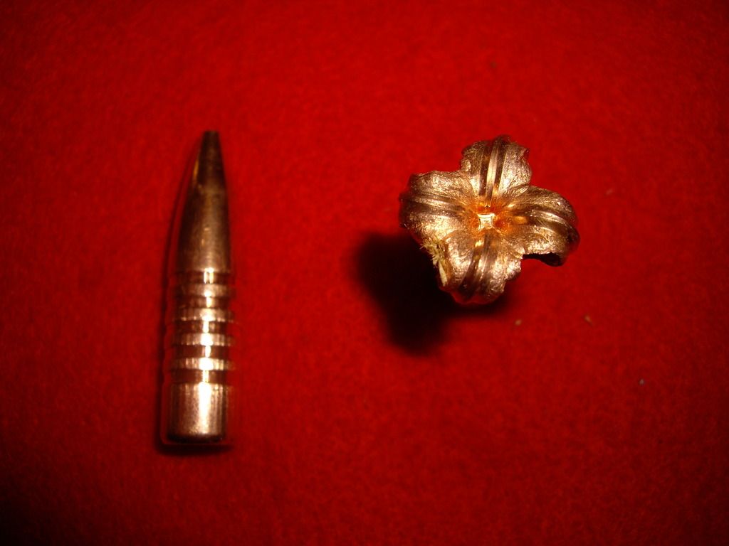

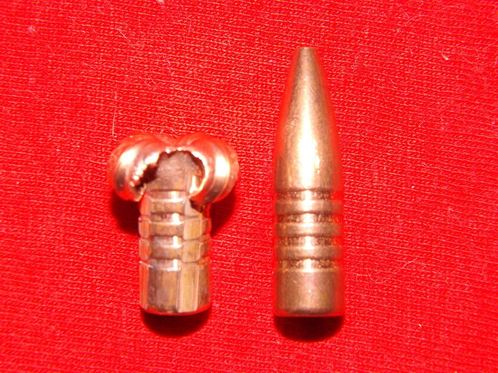

10. 250gr Barnes TSX found in the 7th jug 250.4 grains
11. 250gr Barnes original Solid 10th jugs then exited
12. 250gr Barnes original soft point 5th jug then exited, second shot the same
13. 250gr Speer 5th jug then exited, second shot found in the 5th jug a little part 2.6 grains but exited ...
14. 250gr Hornady gmx exited in the 4th jug, second shot found in the 6th jug 8.6 grains
15. 250gr barnes ttsx found after two shots same shape for both 6th jugs found against the 7th perfect mushroom speed 2277fps at 12 feet 6 paces 2345 fps shot by Barnes 270 249 and 248.6 grains
16. 255gr Cutting Edge Safari Raptor exited after 6th jug
17. 270gr speer bullet found in the 6th jug 238.8 grains

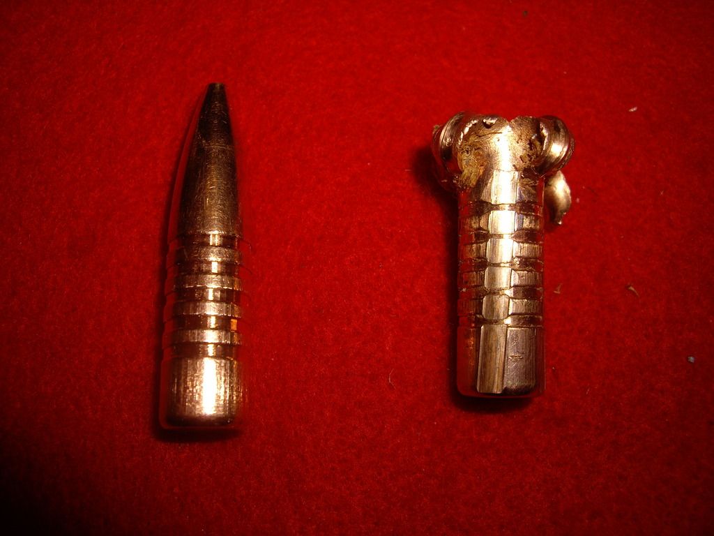

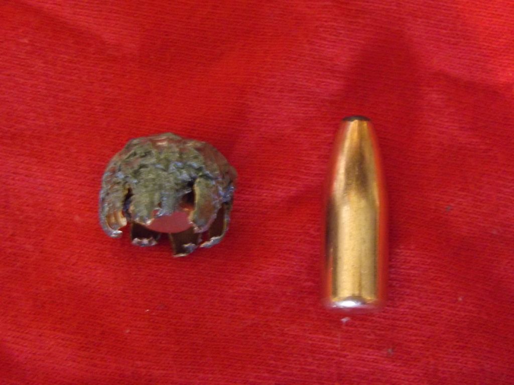

18. 270gr Matrix (just one sample) main part found in the 4th jug 184.8 grains small parts in the 5th jug 8+15.8 grains. total 208.6 grains
you can notice how the impact flattened the bullet.
19 285gr PRVI 2 main parts found (one against the 5th jug) 238.2gr found head 156.4 + 81.8 rear measured at 2277fps 6 paces (+-8fps) from the muzzle given at 2265fps for a 23.6 inches barrel by the factory.
20. 285 Lapua Mega (very similar to the Partisan) factory ammo one exited after 6th jugs and one recovered in 7th perfect mushroom 247 grains

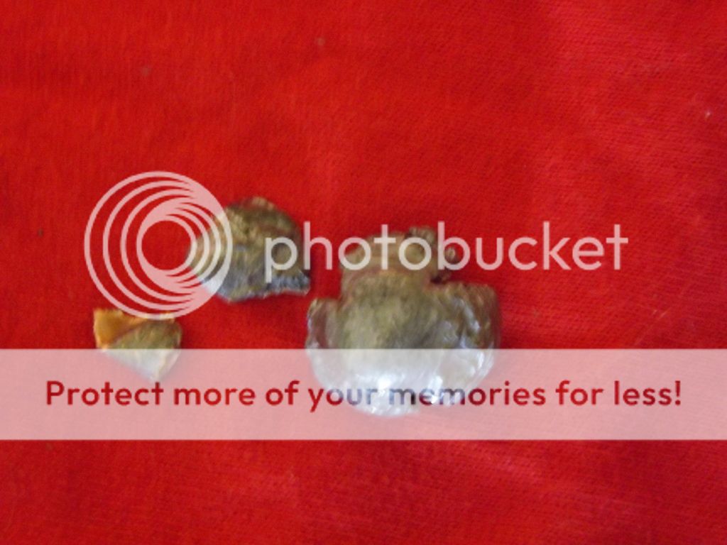

21. 286gr hornady. found in the 4th jug lost most of it what you heard is what we found so far ... very good for practising and that is it. 53.6grains found nothing from the front part at all .
22. 286gr remington Factory ammo 3th jugs found a really little part 3.2 grains . same bullet as hornady.
23-a 286gr Norma Oryx speed 2493fps 6 paces 60 grains varget Lapua brass 6th jugs then exited other shot not found rxited in the 9th jugs. one bullet went against the ditch but not found ... have to try with load test
23-b factory ammo found out of the 6th jugs 270.2 grains

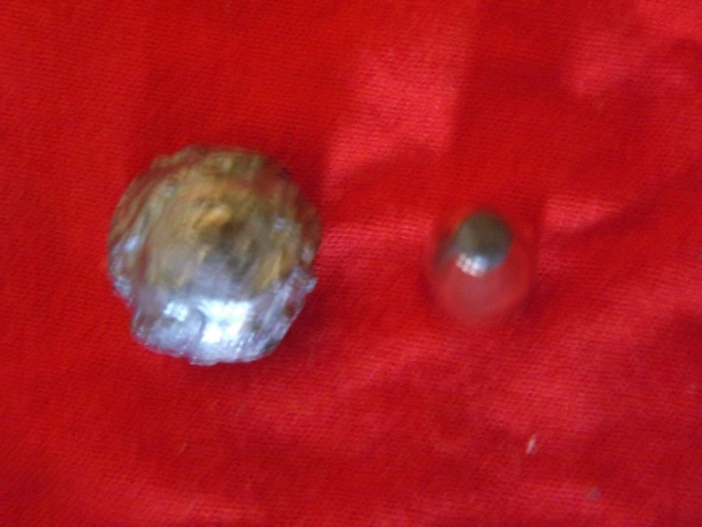

24. 286gr cast bullets found in the 5th jug 20.8 grains
25a. 285gr Nosler partition loaded 60 grains varget 7th jugs then exited not found
25b. 285gr Nosler partition test load 2262fps 12 paces 5th jug found a little of front part rest exited really dissapointed total weight 190 grains 150 +40
25c load test found in the 5th jugs 266.8 grains 212.8 +53.8 grains a better result.

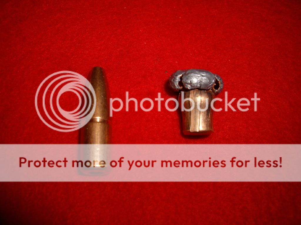

26. 285gr norma plastic dual core (yellow tip) was too low on the shot but some parts crossed 7th jug despite hitting some wood. second shot found one stopped in the 6th jugs low and met some wood also 202.6grains with wood in
27. 285gr Woodleigh RN 7th jug perfect mushroom 284.4 grains
28. 285gr Woodleigh PPSN 6th then exited
29. 285gr Woodleigh Hydrostatic stab. projectile 4th jugs with a lot of water explosion

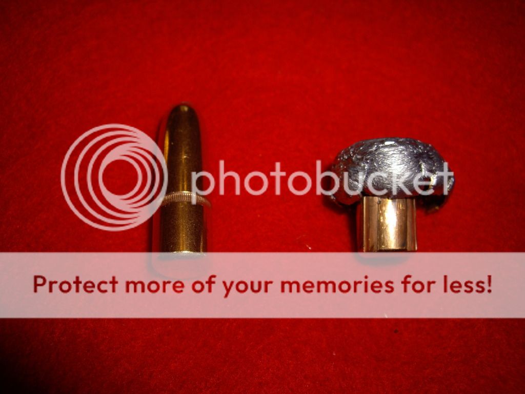

30. 285gr Norma Alaska found in the 5th jug one part 245gr perfect mushroom
31. 286gr TSX Barnes 2210fps at 12 paces hit one jug then went inside hard wood for the equivalent distance of 4 jugs impressive to say the least. not that much room for that bullet in a 9.3x62 case 287.6 grains with wood in.
32. 286gr Norma same as alaska
33. 286gr swift a frame went throughout 8jugs and still flying another test 6th jug then exited bullet found later 283.4 grains
34. 290gr Matrix FB Bonded found in the 6th jugs 286.8 grains perfect mushroom
35a. 300gr Swift a frame 5th jug then exited
35b found outside of the 9th jug 299.6 grains
36a. 320gr woodleigh PP sn 4th jug then exited a little low.
36b exited after 4 jugs low, exited after 9 th jug then cross two side jugs ...
37. 320gr Woodleigh RN found in the 8th jug 317.6 grains
38. 325gr Norma Oryx 1st shot 3rd jug then exited, 2nd shot 3rd jug then exited
38b 10 jugs then exited.
39. 250gr Swift a Frame found against the 7th jug 249.6 grains
40. 232gr Norma Oryx found in the 6th jug 220 grains

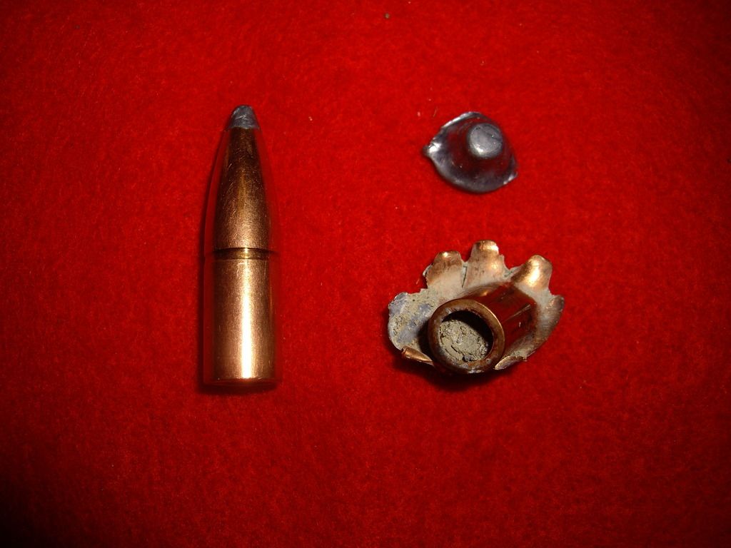

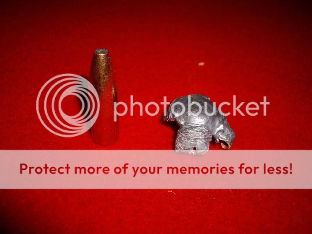

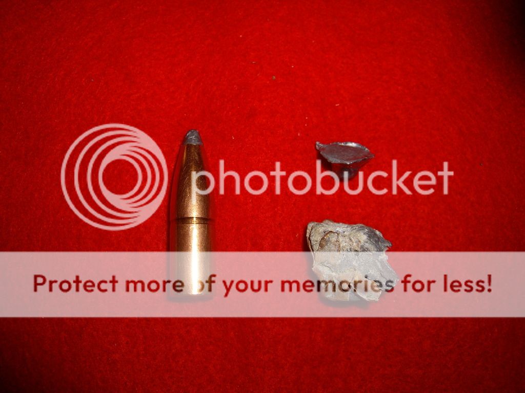

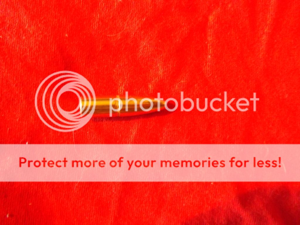

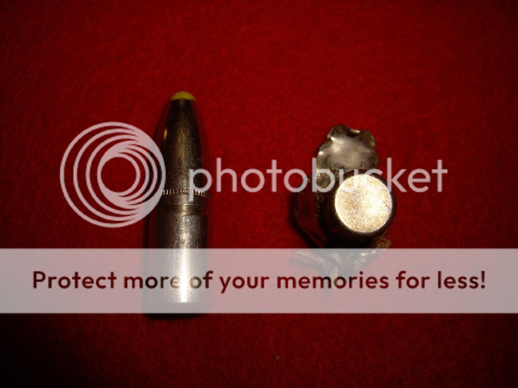

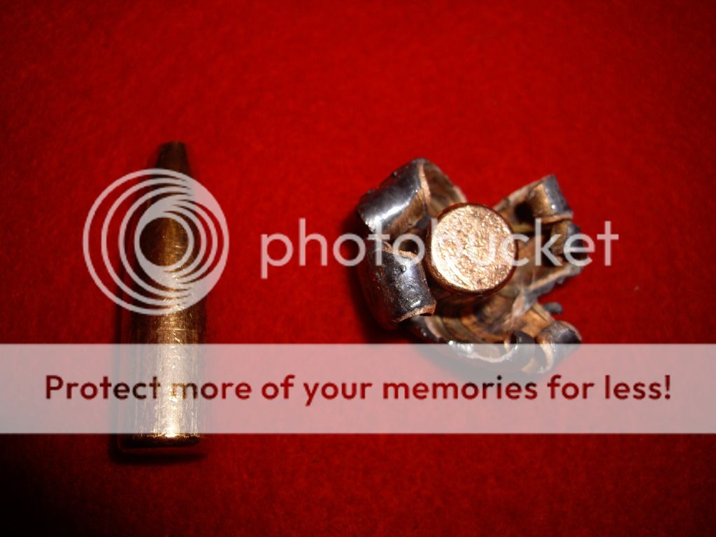

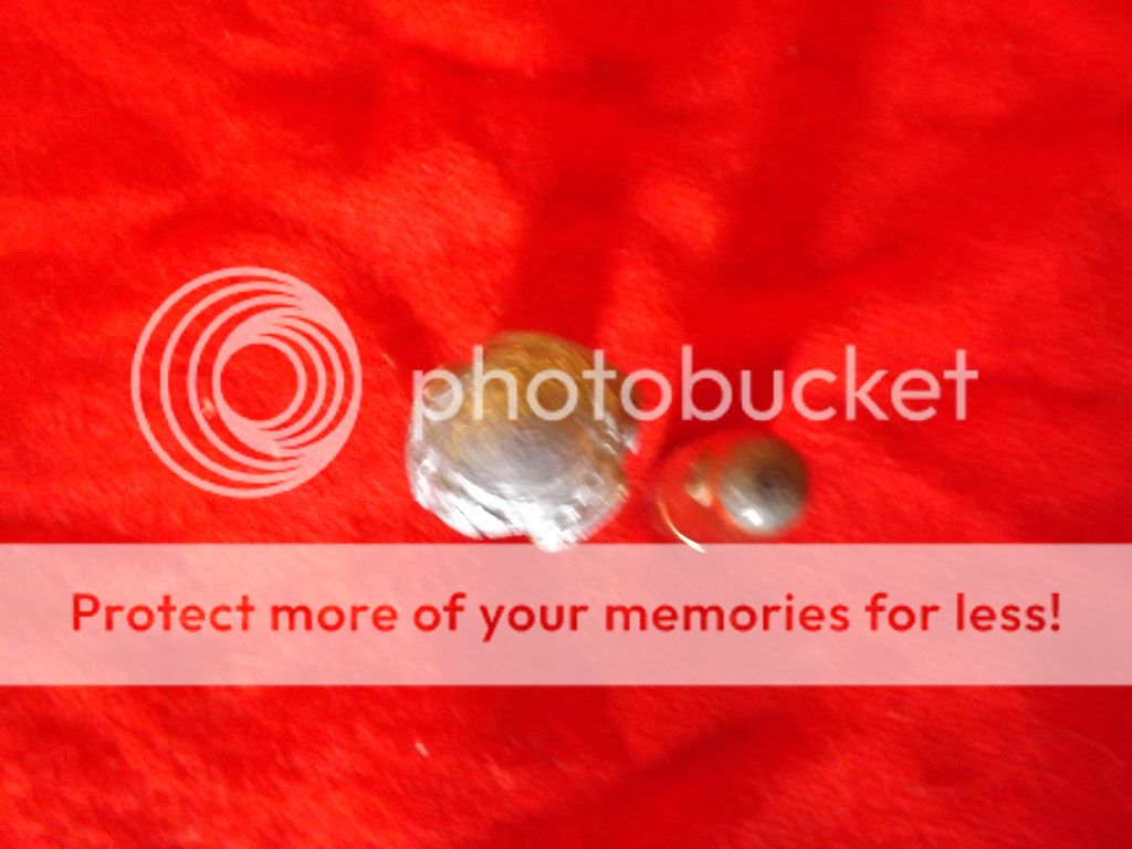

the water and jug test is really traumatic for the bullets but good answer on some questions.
