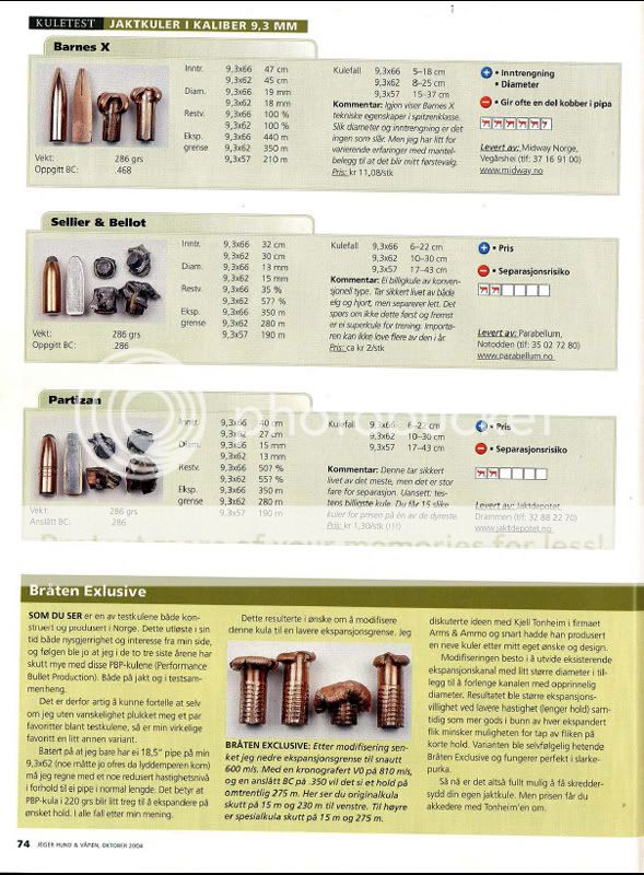

Was looking around the net regarding 9.3 bullets and found these pictures, calibers used for the test is 9.3x66, 9.3x62, and 9.3x57
This website has a lot of very good information.
http://forums.nitroexpress.com/showflat.php?Cat=0&Number=94935&page=0&fpart=all&vc=1
I also found the translation of the article, from the same website I found the pictures:

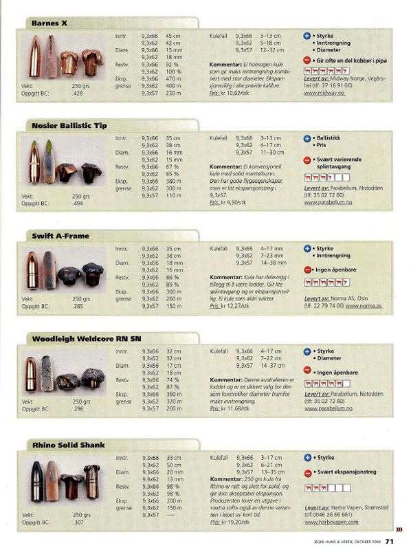

The comment text in each bullet evaluation:
"Inntr." = Penetration
"Diam." = Expanded diameter
"Restvekt" = Remaining bullet weight
"Eksp.Grense" = Distance when velocity becomes so slow that it will not expand reliably.
PBP 220grain: The tests only Norwegian produced bullet. Simply a top notch hunting bullet
for the 9,3x64/66 and 9,3x62. Monometal copper.
+Strength
+Penetration
+Diameter
-Reluctant to expand when the velocity is very low.
Norma Vulcan 232 grain: Conventional lead filled bullet. Holds together surprisingly
well, but can't take too much before coming apart.
+Price
-Seperation risk
-Little penetration
Rhino Solid Shank 235 grain: "Semihomogeneous(semi-monometal)" South African produced
bullet with a small portion of bonded lead in the front. High remaining bullet weight and
large diameter. A little stiff at low speeds, but the producer promises a "extra soft"
variant soon.
+Strength
+Diameter
Brenneke TOG: Brenneke's new generation of bonded bullets. Expands willingly in all 9,3mm
cartridges, but looses a bit of weight.
+Balanced penetration and diameter.
-Looses some weight/some shrapnel.
Barnes X 250 grain: Homogeneous/monometal bullet that gives maximum penetration combined
with a large expanded diameter. Willingly expands at the velocities of all 3 tested
calibers.
+Strength
+Penetration
+Diameter
-Often leaves a lot of fouling in the barrel.
Nosler Ballistic Tip 250 grains: A conventional bullet with a solid rear part of the
jacket. It has good flight characteristics, but is a little reluctant to expand at 9,3x57
velocities.
+Ballistics
+Price
-Very varying results regarding loosing lead/shrapnel.
Swift A-Frame 285 grain: The bullet has a solid partion between the top and bottom in
addition to being bonded. Looses very little lead and willingly expands. A bullet that
never fails.
+Strength
+Penetration
-None that are obvious.
Woodleigh Weldcore RN SN 250 grain: This Australian is bonded and is a good choice for
those who prefer expanded diameter rather then maximum penetration.
+Strength
+Diameter
Rhino Solid Shank 250 grain: The 250 grain bullet from Rhino is simply too solid and does
not give acceptable expansion. The producer promises a "extra soft" variant will be
available soon.
+Strength
-Very unwilling to expand.

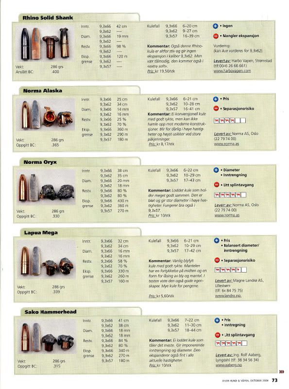

(Note from ErikD: I read a similar test in a Swedish magazine published this months, and
the Rhino 250 grain got the same results as before. Which leads me to believe that they
have not released a "softer" version yet.)
Speer 270 grain: A traditional lead filled bullet that is cheap and generally usable at
lower velocities. However, it is not a safe bet when bone is hit.
+Price
+Penetration
-Seperation risk
Lapua Naturalis 270 grain: Earlier reluctency to expend appears to have been dealt with,
because now this bullet is impressive. It gives moderate penetration, but delivers an
unusually large expanded diameter, and 100% retained weight. The length of the bullet
does steal a little case capacity though.
+Strength
+Diameter
-Long length of bullet.
Swiss Jagt CDP 286 grain: Has a constuction very similar to the Nosler Partion, but is
undoubtedly more solid. This bullet has also been made to expand more easily as the years
have passed, and does well both when it comes to penetration and diameter.
+Penetration
+Diameter
Woodleigh Weldcore PP 286 grain: Bonded bullet with "Protected Point". Gives a lot of
penetration due to not so much expansion at high velocity, but gets opposite results at
lower speeds (?!?!?). Is not very willing to expand, and is thus not very suitable for
the 9,3x57 and is even a bit too stiff for the 9,3x62 also.
+Strength
+Diameter
-Looses a little weight/shrapnel
Nosler Partion 286 grain: An old classic that has gotten a lot of competition. The
partion between the front and rear guarantees weight retention, but generally the front
part looses all it's lead. The published retained weights include lead that is often
found together with the rest of the bullet.
+Penetration
+Price
-Shrapnel
Rhino Solid Shank 286 grain: This Rhino is also way too stiff, which results in no
expansion in 9,3x62. But be patient, as a "Extra soft" variant is also promised.
+None
-No expansion
Norma Alaska 286 grain: A conventional bullet with a good reputation, but can't stand up
to the more modern bullet constructions. Does not hold together well at higher speeds or
under stress.
+Price
-Risk of seperation.
Norma Oryx 286 grain: A bonded bullet that stays together very well. It is soft, which
results in a large diameter at higher speeds. Works well in 9,3x57 too.
+Diameter
+Penetration
-Some shrapnel.
Lapua Mega 286 grain: Conventional lead/copper bullet with a good reputation. The jacket
has a thicker portion in the middle, which locks the core to the jacket. The test showed
good results. A lot of bullet for the money.
+Price
+Well balanced diameter/penetration
-Seperation potential
Sako Hammerhead 286 grain: A bonded bullet that can handle most situations. Shows
impressive penetration and diameter. It also expands willingly at all relevant
velocities.
+Price
+Penetration
-Some shrapnel.
Barnes X 286 grain: Barnes X shows once again a high level of technical qualities. The
diameter and penetration is second to none. But I have too much varied experience when it
comes to copper fouling to make it my first choice.
+Penetration
+Diameter
-Copper fouling.
Sellier & Bellot 286 grain: A cheap bullet of conventional construction. Can probably
kill both moose and red deer, but the core seperates from the jacket too easily. This is
probably a great bullet to use for practice. The importer can not promise any more this
year.
+Price
-Seperation risk
Partizan 286 grain: It can probably kill most things, but with a very great risk of the
core seperating from the jacket. No matter what, it's the tests cheapest bullet. You can
buy 15 of these for the price of 1 of the more expensive bullets.
+Price
-Rik of seperation
Swift A-Frame 300 grain: This bullet weight is best suited for the 9,3x64/66, but I have
added the data from the 9,3x62 also. It is a bullet that works under all conditions, but
low speed and moderate BC doesn't exactly help the trajectory.
+Strength
+Penetration
-Short range bullet.
Rhino Solid Shank 300 grain: This bullet is in the same catagory as the previous (Swift
A-Frame 300 grain), but this one delievers a large diameter at the cost of lower
penetration. It's need for velocity to expand reliably, and to get decent trajectory,
diqualifies it from being useful in the 9,3x62.
+Strength
+Diameter
-Penetration
Short range bullet.
Woodleigh Weldcore RN SN 320 grain: Actually a bullet for the old .360NE Nr2, but works
in 9,3x64/66 as an alternative in dence bush.
+Strength
+Penetration
Diameter
"Bråten Exclusive"
As you can see, one of the tests bullets is designed and produced in Norway. This peaked
my curiousity and interest, and resulted in me using these PBP (Performance Bullet
Production) bullets quite a lot these last few years. Both for hunting and for testing.
Thus it is my pleasure to tell you that although I quite easily picked out a couple of
favorites amongst the tested bullets, my real favorite is a slightly different variant.
Since my 9,3x62 has a 18.5 inch barrel (I sacrificed length when I put on a moderator to
keep the overall length down), I have to accept a slightly reduced muzzle velocity
compared to a more conventional barrel length. Therefore the PBP 220 grain is a little
reluctant to expand at my preferred distances. In my opinion.
This resulted in me wanting to modify these bullets so they would expand reliably at a
lower velocity. I discussed this with Kjell Tonheim at the company Arms & Ammo (who
produce the PBP), and he shortly made up a handful of bullets designed to my wishes and
specifications.
The modification was to expand the existing hollowpoint to a slightly larger diameter in
addition to making it slightly deeper. The result was a bullet that was more willing to
expand at lower velocities (longer distance), while at the same time more material at the
end of each expanded petal lessened the likelyhood that they would break off at shorter
ranges. This variation was naturally named "Bråten Exclusive" and functions perfectly in
my rifle.
So it is fully possible to have your bullets custom made if you wish. The price however
is something you'll have to discuss with Tonheim.
