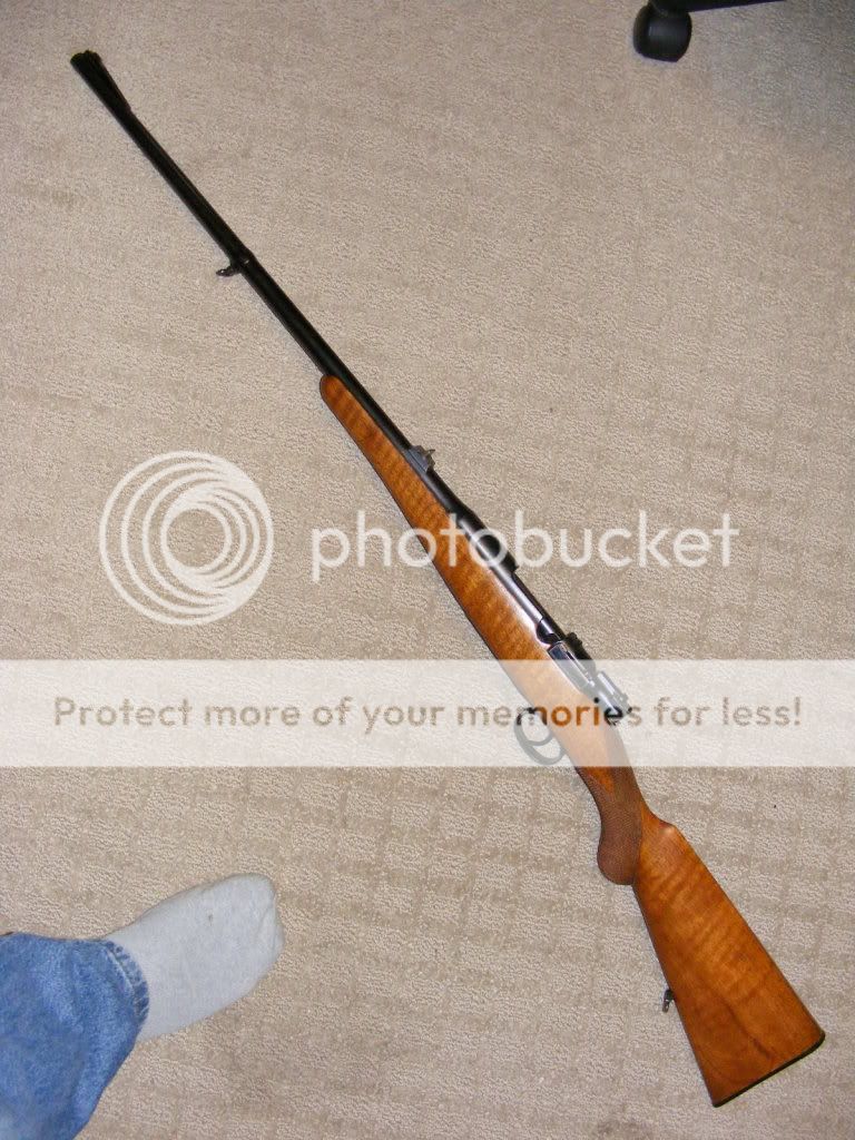

The eyes are definitely a limiting factor now with irons. This picture is from a few years ago with an early M46. Earlier thread: Cast bullets in a 9.3 x 57 (canadiangunnutz.com)
