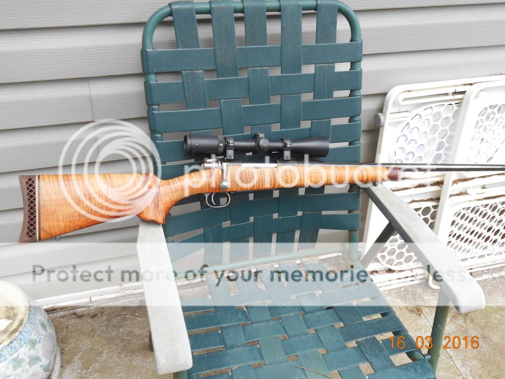

I'm biased toward the 35 Whelen but the 9.3X62 is a superb cartridge as many have found out and hopefully this Fall I can fill a tag with it.
I'll post a picture if I can find it.
It has a 24" barrel and I've been thinking about shortening it a couple inches but it shoots so well I think I should leave well enough alone.
And it balances nicely.
