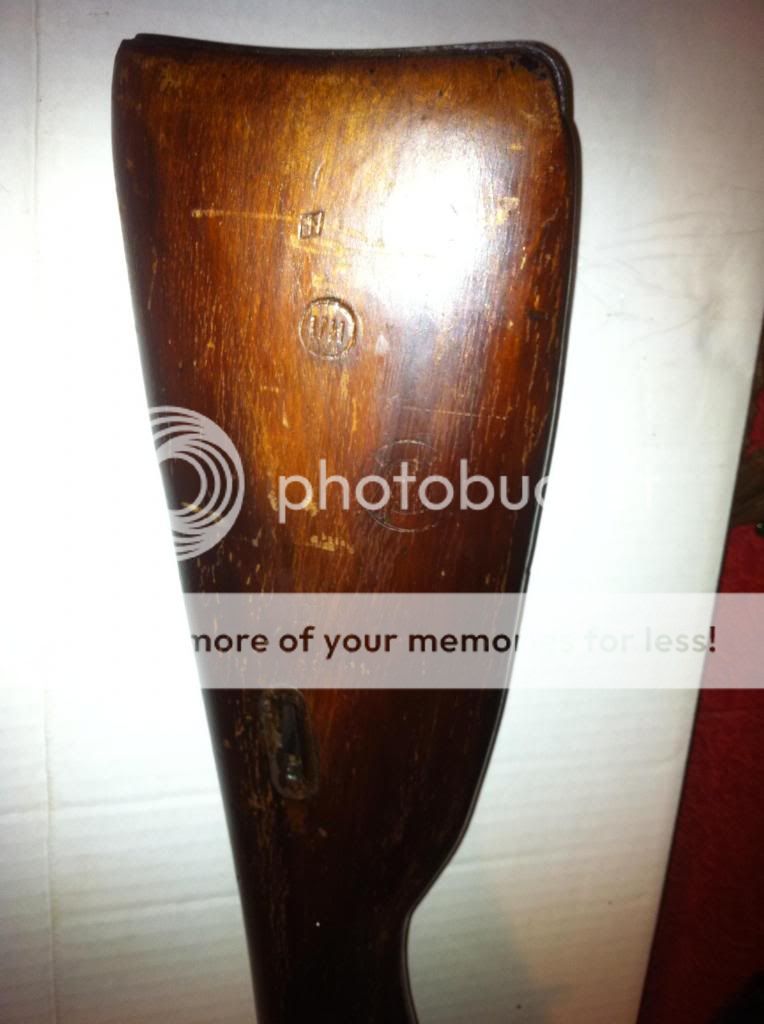

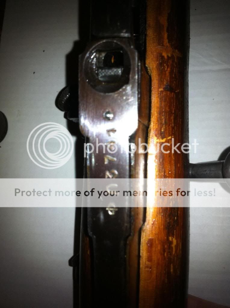

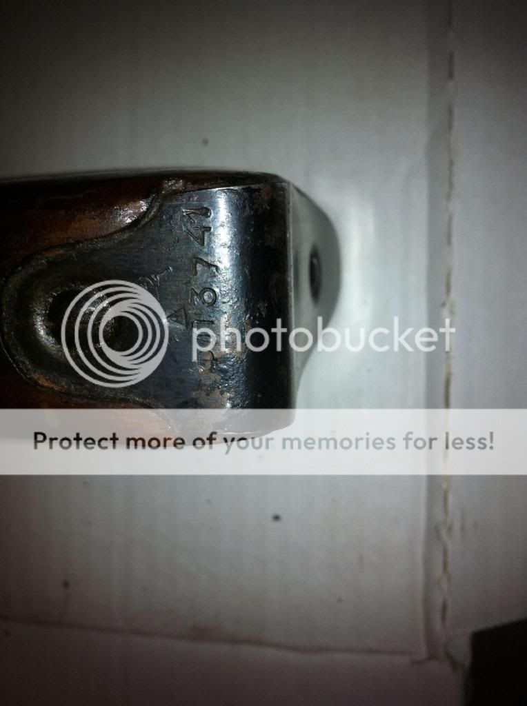

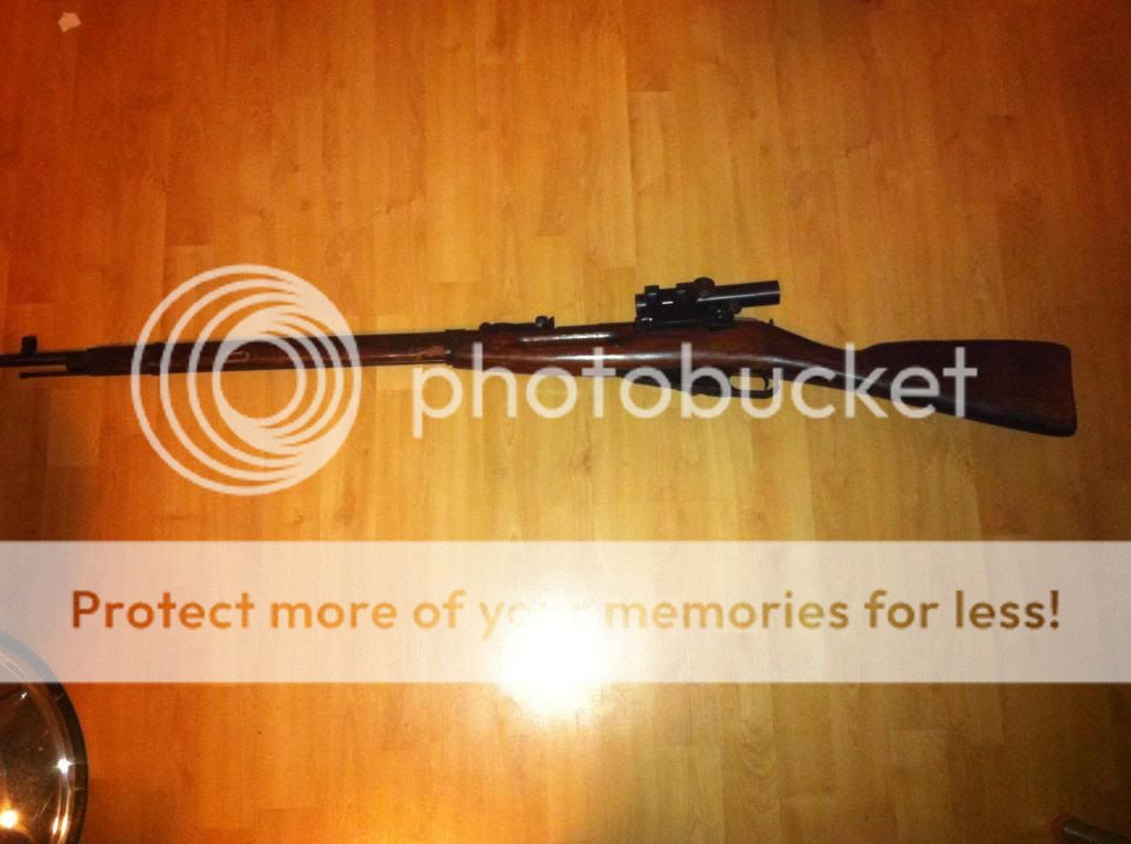

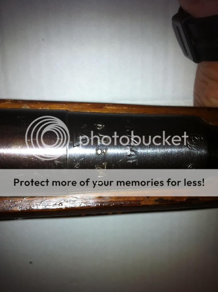

Happy New Year everyone. Got this one this evening. 1944 Izhevsk Mosin sniper. Looks pretty close to original to me. Scope matches the # on rifle....the font and style looks original(I have 2 others with scrubbed numbers and restamped, font is different). Looks like scope made in 1944.
All serial numbers are original, font matches everywhere. No scrubbing everywhere, and as like I said the font is 100% matching. No electropencil anywhere. Every part of the rifle whether it is big, little or small is stamped with arrow in triangle. Stock has PRESSED in escutcheons, however has a coat of shellac over original finish. Rollmarks on stock are intact. Stock is shimmed at trigger assembly. No refurb markings on steel or wood. My opinion that this one has seen a refurbishment just by applying a coat of shellac over it, including metal:) What do you think?
Looks good to me.If it was refurbished it would have a square with a / in it.Not about to go down and check mine but the slash could also be\.

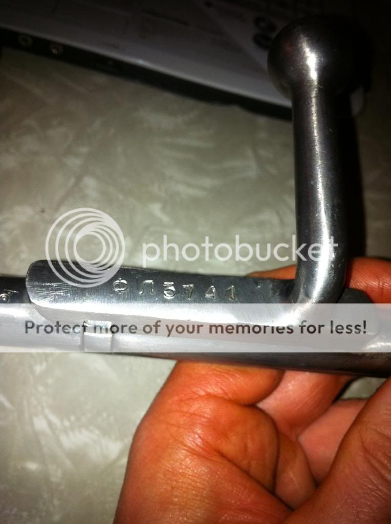

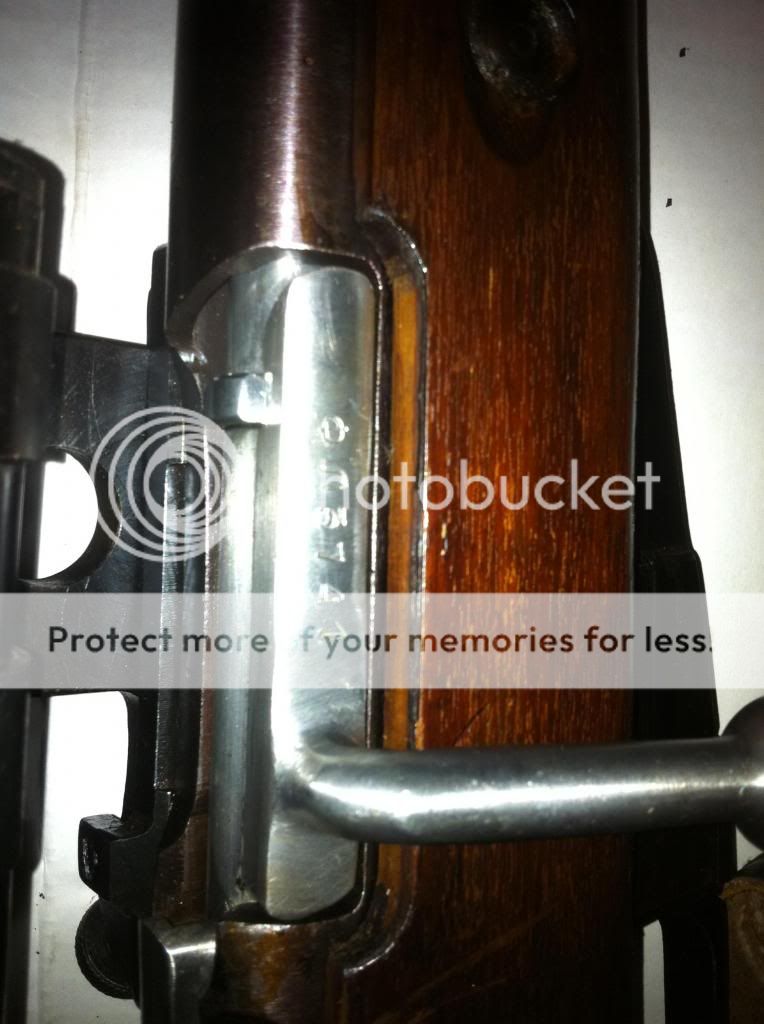

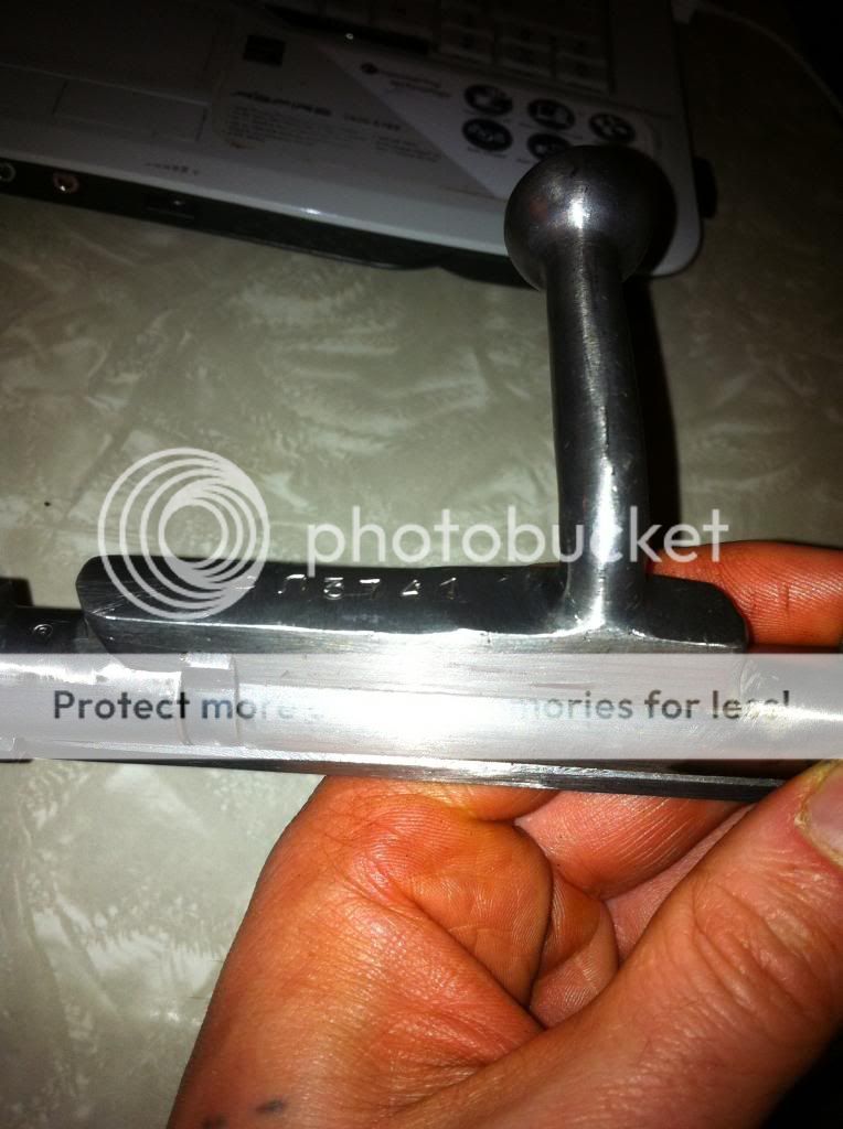

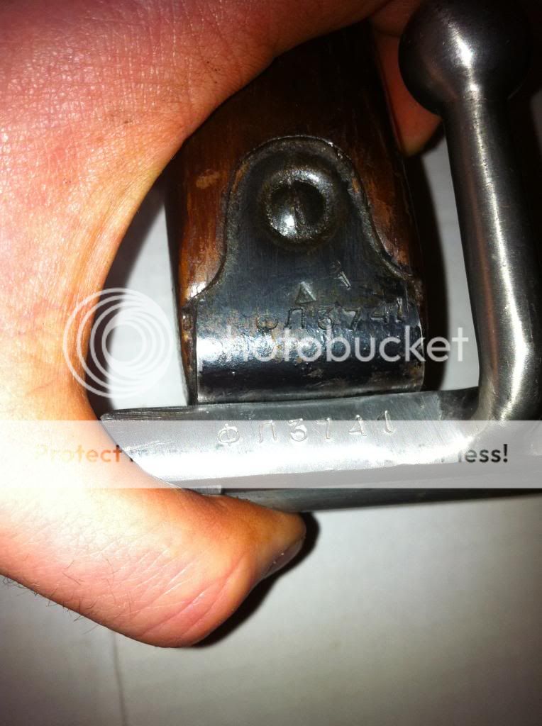

Not all refurbs are marked as such. I would have to see the rifle in person but the bolt looks to have been renumbered. The more likely scenario is that it is a better than average refurb. Molot?

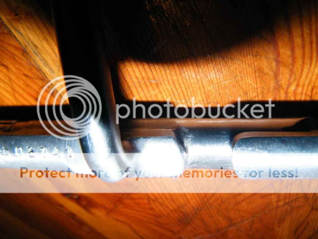

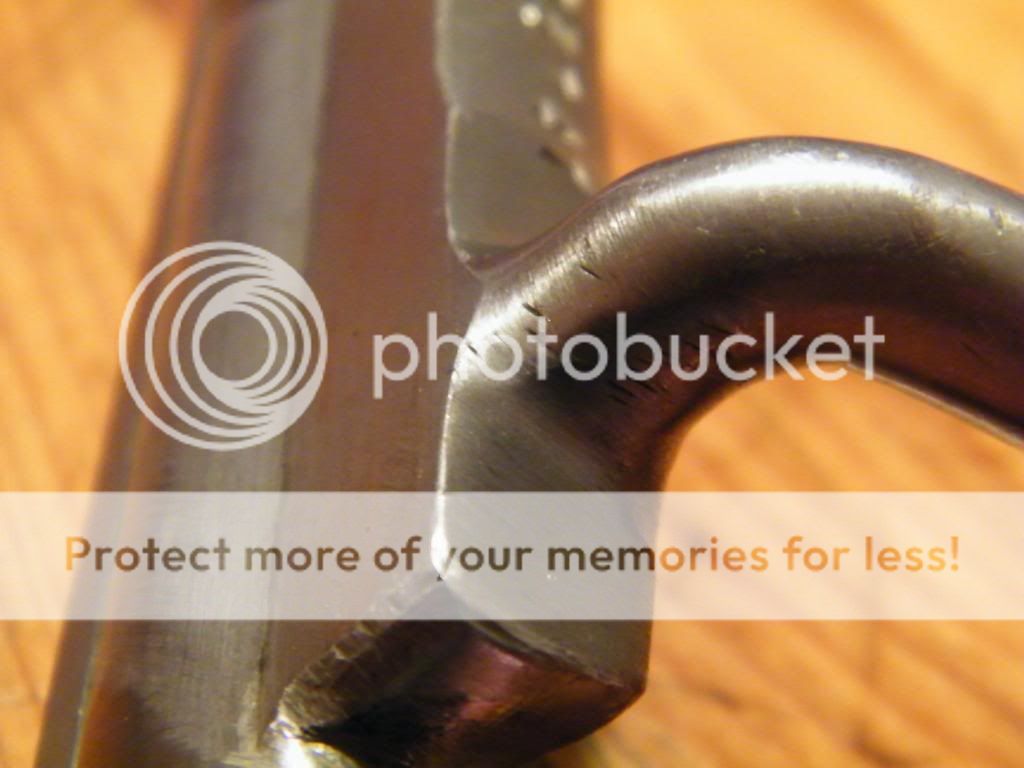

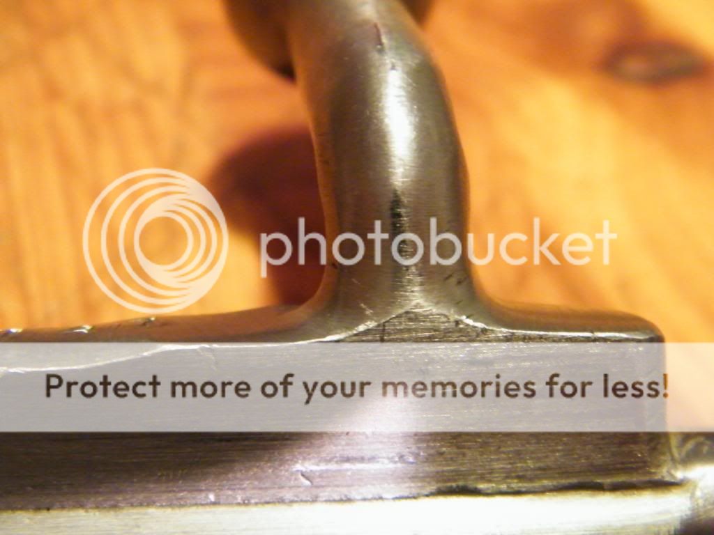

Yep. Molot. I am sure it is way better refurb than others(I have 2 more) The finish on bolt looks a bit rough, but no sign of refurbishment IMHO. Have a look:

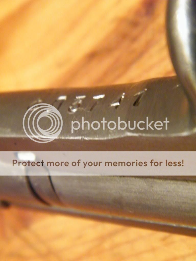

How does original stamping look like? It is rather carving here, not stamping. Looks like 1944 Yoshkar Ola production scope IMHO. I base it on the info from american forum. Will post close up pic later.

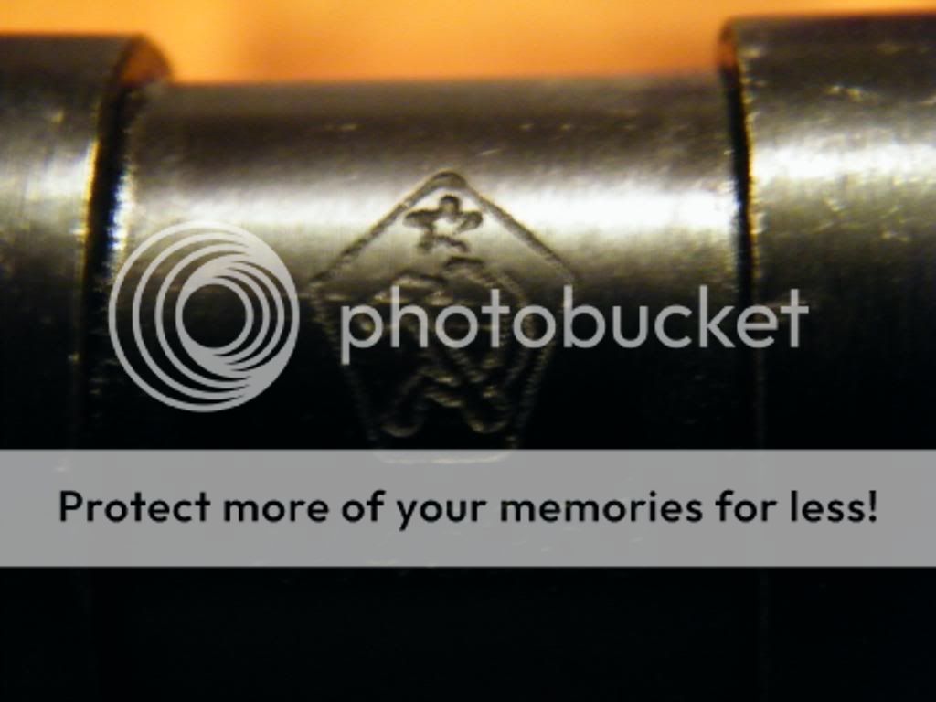

P.s it looks like there's a refurb mark on the stock in the 4th pic. The square with the line down the middle.
http://russian-mosin-nagant-forum.com/information/marks/

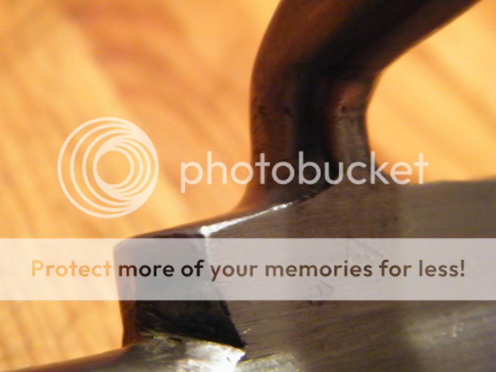

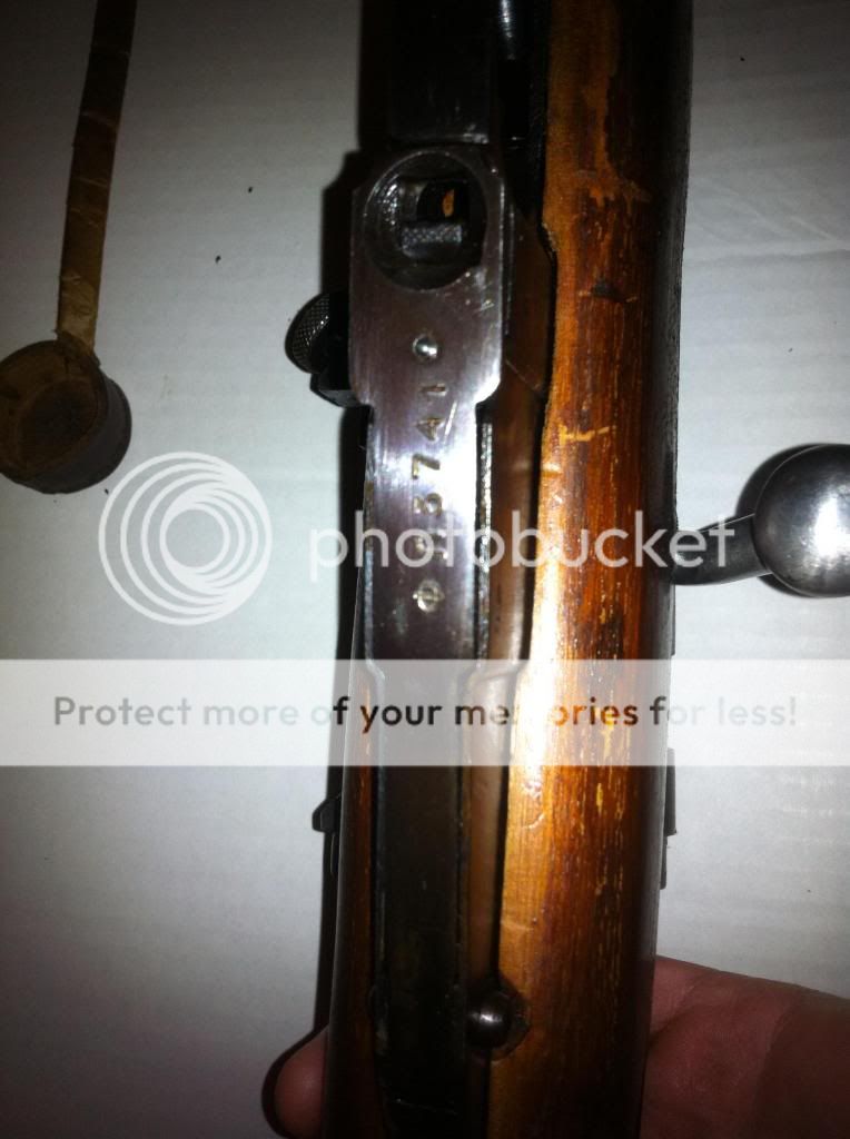

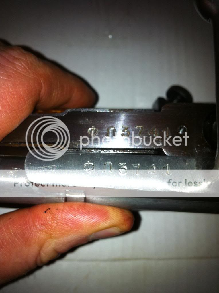

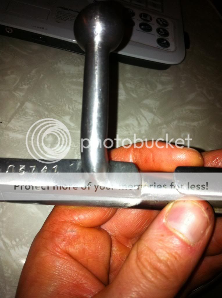

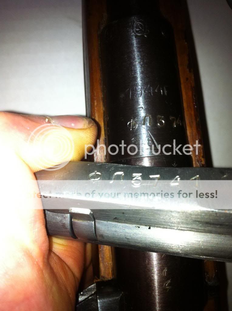

Here are two photos showing serials up close. Top photo has one original bolt with two molots all Izhevsk.
This shows two 43 Izhevsk ( the rough ones ) & a 41 Izhevsk & the bottom is a 40 tula all original stampings. The difference in shape & texture between the original & renumbered bolts is quite pronounced.

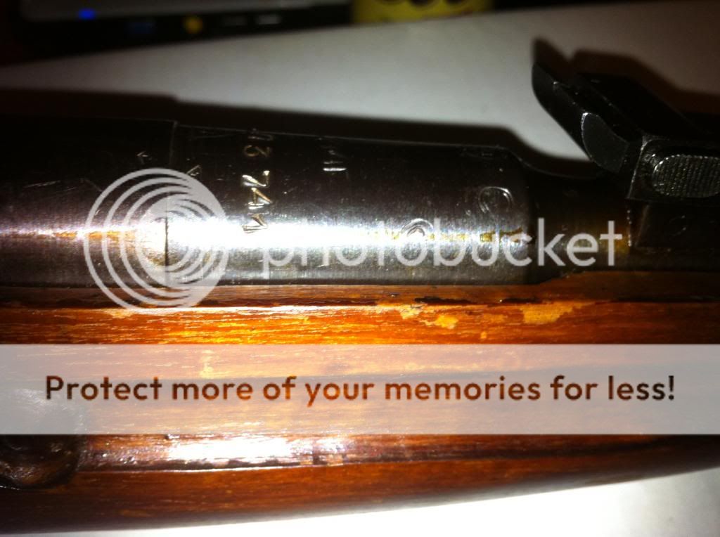

Desporterizer, I have a couple of original Mosins and the finish looks similar to ones you posted. The early rifle bolts have better finish, war production is more rough. I can only guess about the bolt in question though. It looks like this bolt is not polished enough after production/conversion of bent handle. Rough job at production or at refurb, I guess. BUT, IMHO the FONT looks very identical to the one you showed on your 1st photo, the one on top...Have a look:
And scope...:
I haven't put much faith in fonts since seeing an obviously refurbed rifle with exactly the same font as the serial on the barrel. I look more for shape & metal finish these days.
