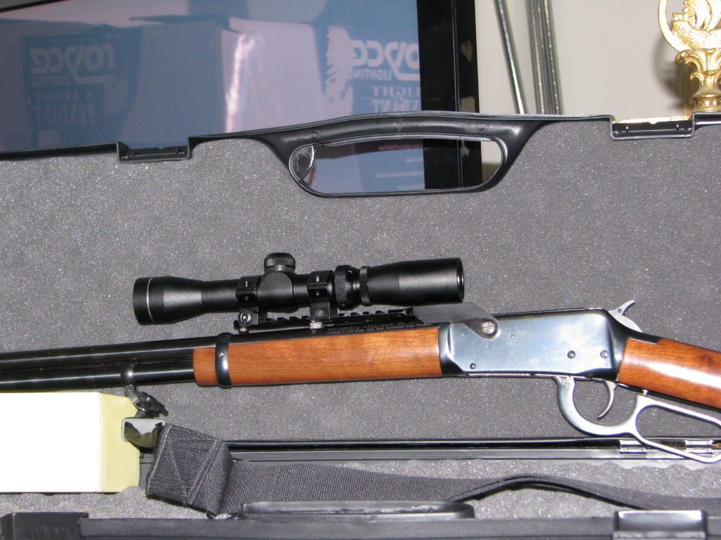

After several attempts to scope Winchester lever guns, with some success but always having something that wasn't quite right, I have decided the best method is to "home mount" a red dot or similar "mini" scope that has a bit of magnification.
It aint purty...but it works!! To make the mount you just need a few hardware store supplies and a couple garage tools...a couple short pieces of alum angle and some hardware machine screws . The only thing that needs ordering is a short piece of Ticanini scope base (less than 3 inches. The scope base mechanism screw attaches to the already drilled & tapped tang site position.
Tools needed ar, e screw driver, hack saw, small file to remove saw burs , and a drill of some kind either drill press( preferably) or a simple hand drill.
It aint gonna be a 400 yrd shooter with one of these scopes but 1-200 is sure doable.

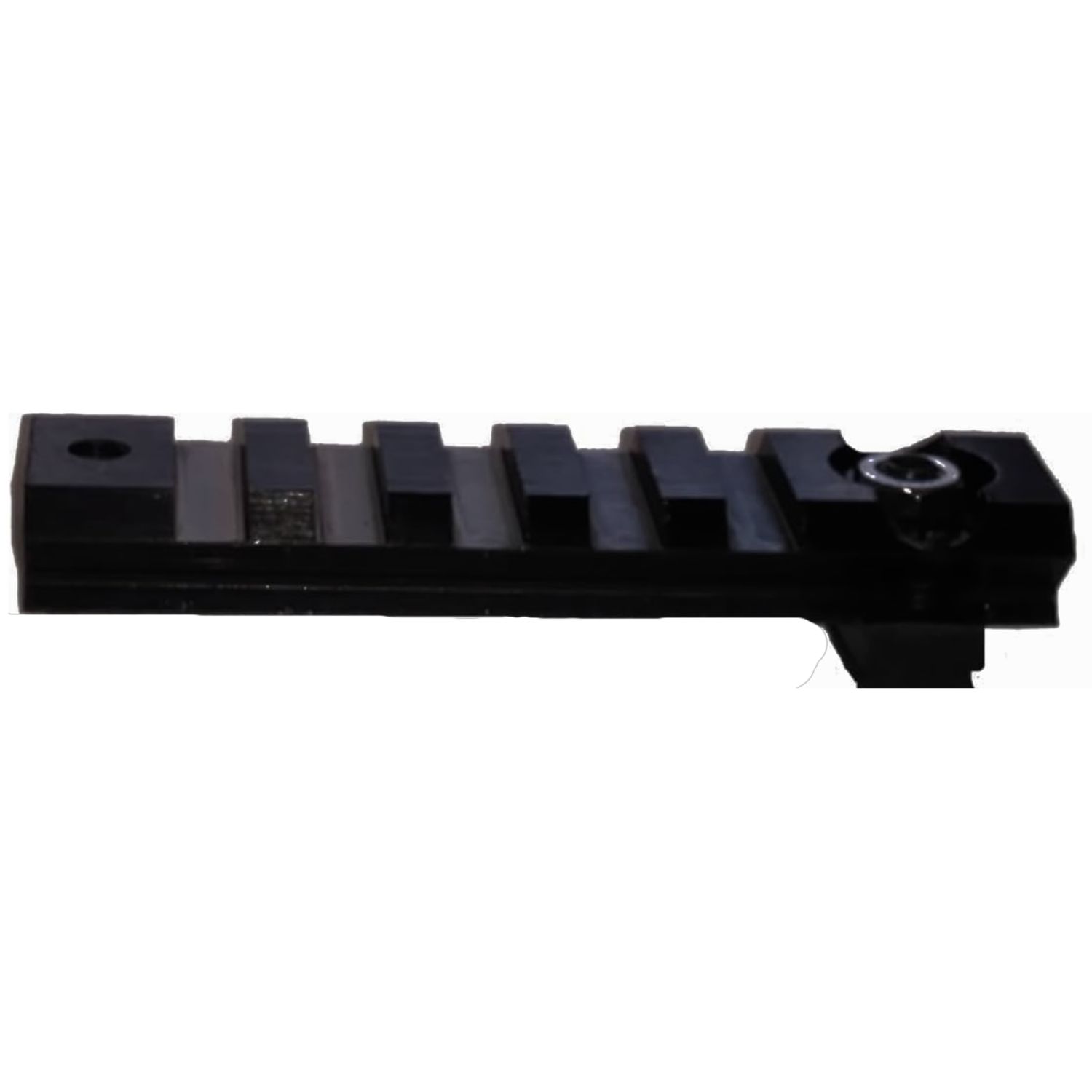

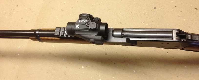

Dr. Pearsons No Drill Rails is a good option, not sure if they still ship north under current regulations but it could be likely ordered through IRG's import service if needed.
https://mod94scoperail.com/
The rail is forward of the action so if you want a magnified scope it would have to be a long eye relief scout type or possibly a pistol scope.
He makes a short section of rail that mounts to the rear sight dovetail as well for smaller red dots.
