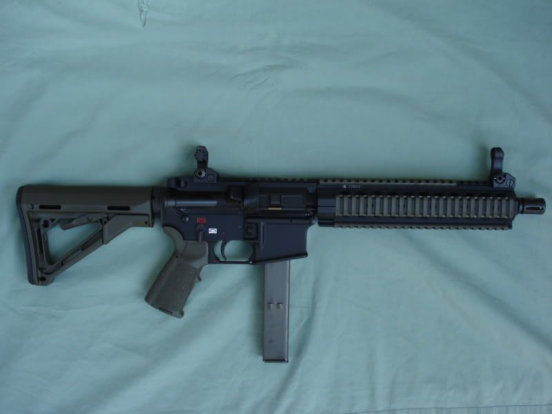

Got a little busy, but finally got around to correcting the build. Here is the 99% solution. Magpul stock and grip, milspec buffer tube and carbine buffer spring (thanks Wolverine, fast work and John patiently answered my obvious questions). Besides additional mags, the only thing I want to add at this point is a vertforegrip and sling.
With the proper buffer spring and Magpul stock there is no rattle with the Spikes heavy buffer. Feels and sounds really good. Lesson learned.
I love the look and feel of this rig. Everything is positive and tight. The nose is a little heavy, but I like it. It is very quick to the shoulder and points well.

Some notes on the build:
1) I did not have a dedicated 9mm AR upper vice block. I found that in order to get the dust cover installed it had to go on before the barrel nut. So I cut out the top half of the vice block from the front of the 9mm deflector back in order to mate it to that side of the upper. Worked like a charm. It should still work fine for a standard AR or I'll just buy another set and call this one my 9mm AR vice block set.
2) This is my second total build and if you just take your time its no problem. Even the detent and springs went in easier this time (only shot one across the room once). I followed the build info at ARFdotCOM and Brownells AR video section.

Anyway, I finally took the backburner project out of medium term storage and took the 9mm AR to the range to see how she runs and man I am a happy camper! She runs like a top! After some initial issues with reloads, I've run 150 rds of Blaser (brass) 9mm through 2 CP-Lar 10rd mags without a single slow down. Locked after last rd every time and no issues with mags loaded to max. Almost illegal how much fun a shorty 9mm AR can be.
Now that I know the CP-Lar 10rd mags run smooth with the mag block where it is, I'm going to mod my Uzi mags with the cut for mag release at the same location as the CP-Lar mags. They won't lock back on last rd, but meh.
