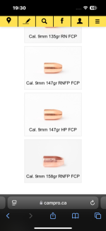

3 grains is negligible and considered the same, you can use the same load data, you should know that.So they don't make a 144gr 9mm bullet. Maybe greatwhite meant 147gr.
WhateverSure, but they don't make a 144gr bullet and we can only assume what greatwhite was actually talking about.
