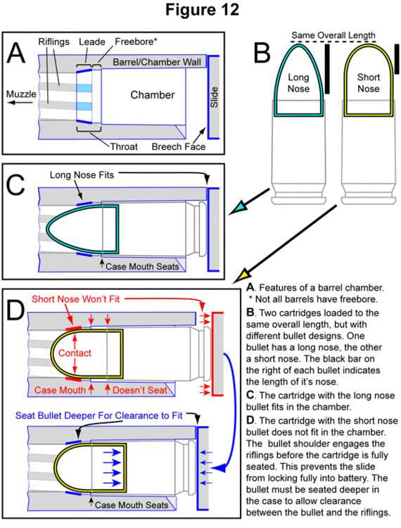

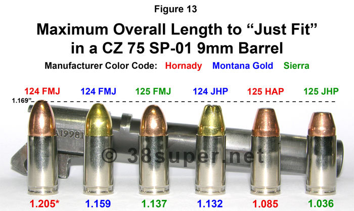

P.S.S. I'm going to sound like a broken record but...you should always determine your own max OAL. OAL's listed in manuals/data are useless. Make a long inert dummy round and continually shorten it until in plunks and spins in the barrel(s) you intend to use with that load. Every bullet/barrel combo is different and when you load a new bullet you should once again determine the max OAL.

I don't question that the plunk test isn't important but before I started reloading 9mm I tried many different manufacturers of 9mm factory loads and the OAL was ALL over the place from one brand to another and they all passed what is accepted as OK in my barrel and all fed just fine in my gun. I did notice that some brands left more powder burns on the exterior of the cases than others however.
I'm not sure what this means, Jim. Factory ammo is loaded to different OAL's because of the different bullet profiles. Those factory OAL's have zero impact on determining your max OAL unless you are loading the exact same components, which you aren't. I only mentioned the plunk test because you indicated that you used the "recommended OAL". You shouldn't use any "recommended OAL", you should always determine your own max OAL, which is what the plunk test was designed to do. It doesn't mean that the "recommended OAL" won't work, it just means that you were lucky enough that it happened to work. From your reply, it doesn't seem like you understand the impact a bullet's profile has on OAL. The diagrams below might help.
I know this isn't the cause of the perceived "snappiness" of your load, I just wanted to provide some information you can use in the future. To be honest, since you loaded Bullseye previously, I can't really understand what changed. Bullseye and Titegroup are nearly identical when it comes to charge weight/performance. I load the exact same charge of both powders and get nearly identical chrono readings.
