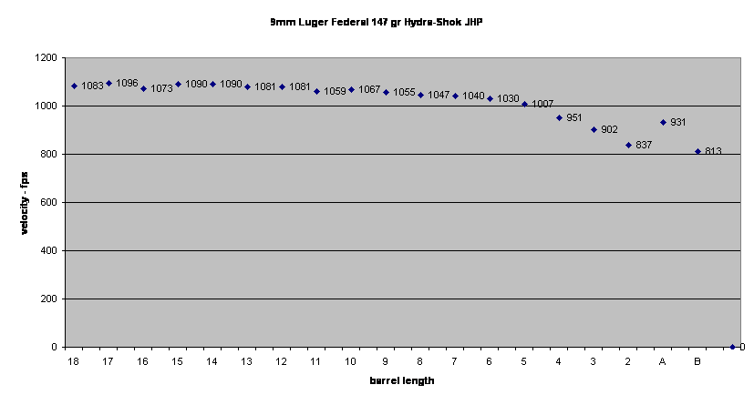

When I was buying a 16 inch 9mm AR upper I looked into velocities of 9mm vs. in a pistol, and while I can't remember the numbers, there was very minimal velocity gained in even a 16 inch barrel. Something like only 100-200 fps gained between 4 and 16 inch barrels.
Looks like I actually saved this chart on Photobucket, from my thread a couple years ago.
For your 2 options there is little to no difference, at least with this load.
Here you go:
Wow... Not much difference at all. That load is close enough to what I have on hand so it's good data.
That's exactly what I was looking for.
Thanks a bunch.
Makes sense.
It uses pistol powder, which burns in a way to achieve maximum velocity from a short barrel. Even with a longer barrel, you will not be able to achieve much more velocity unless you start altering your powder.

Now that I'm thinking of it, I'll grab one of the MP-5's from work and get some velocities, and compare that to my pistols.
Finding the difference between 4" and 9" should give me a rough idea of what to expect in a 10.5".
Regardless, I'll most likely stay with a 7" for the upper.
