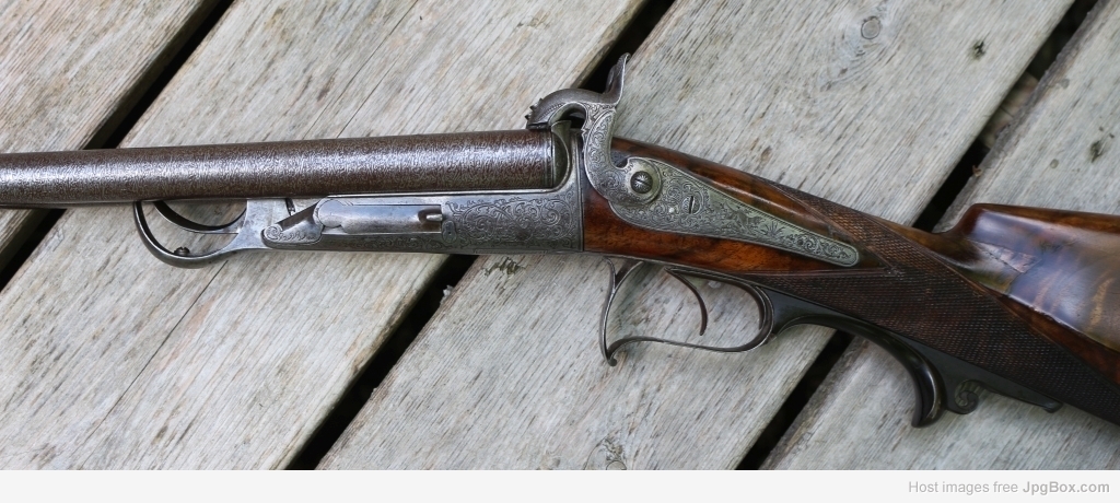

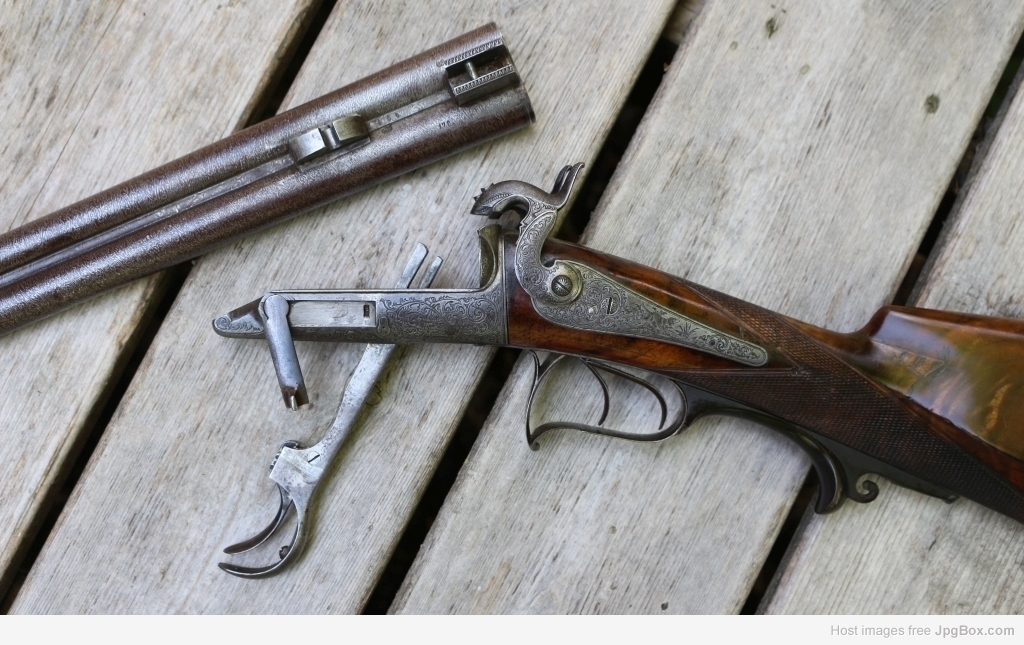

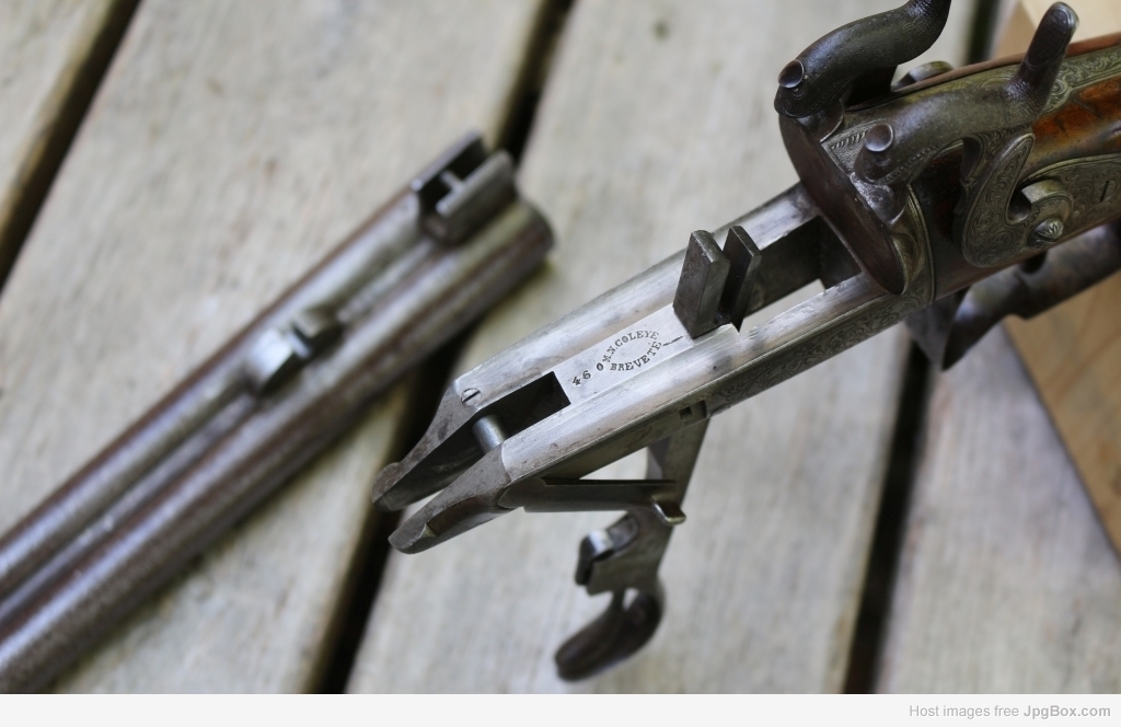

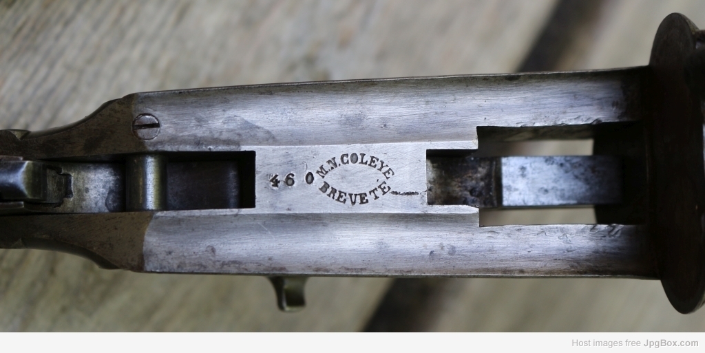

The following is an interesting 16-bore pin-fire gun, and I am looking for additional information on this peculiar action and its enigmatic inventor. The gun has a rib inscription for August Schüler of Suhl, but it is of Belgian origin, with a single Liège provisional proof mark. At first I thought the gun was a Bastin system action, with the pivoted underlever and sliding barrels. I was therefore surprised to find the barrels swung on a hinge, and detached with a release lever on the left side of the action bar. The action is marked “M.N. COLEYE BREVETÉ”, and numbered 490. As the number is shared with the barrel I’m guessing it is the serial number and not a patent use number. As I am unfamiliar with Schüler guns, I don’t know if it is consistent with his numbering system, or is that of a Belgian maker, or that of Coleye if he made the entire gun and not just the action. The action is remarkably smooth and pleasant to use. If you were at the recent Double Gun Classic in Oshawa, you might have seen it.

The gun only has Belgian proof, so it was a gun made in Liege and sold by the German retailer, as opposed to a German-made gun that used the Colleye action under licence, which would have German proofs. Whether Colleye made the whole gun, or someone made the gun using a licenced Colleye action is anyone's guess. It would have been made with Schüler's name already on the rib. Here are additional pictures of the barrels, with the marks. Someone suggested that the 'ML' mark might be for Manufacture Liegeoise (Est. 1866), but their mark is a different oval with a crown - though the simple 'ML' might be an earlier mark, I suppose. This gun will retain a few mysteries. The barrels are acid-etched, possibly displaying a 'Bernard II' damascus pattern.
