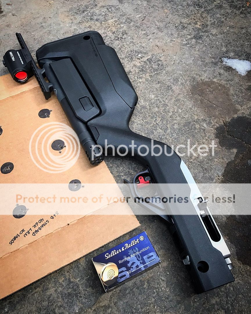

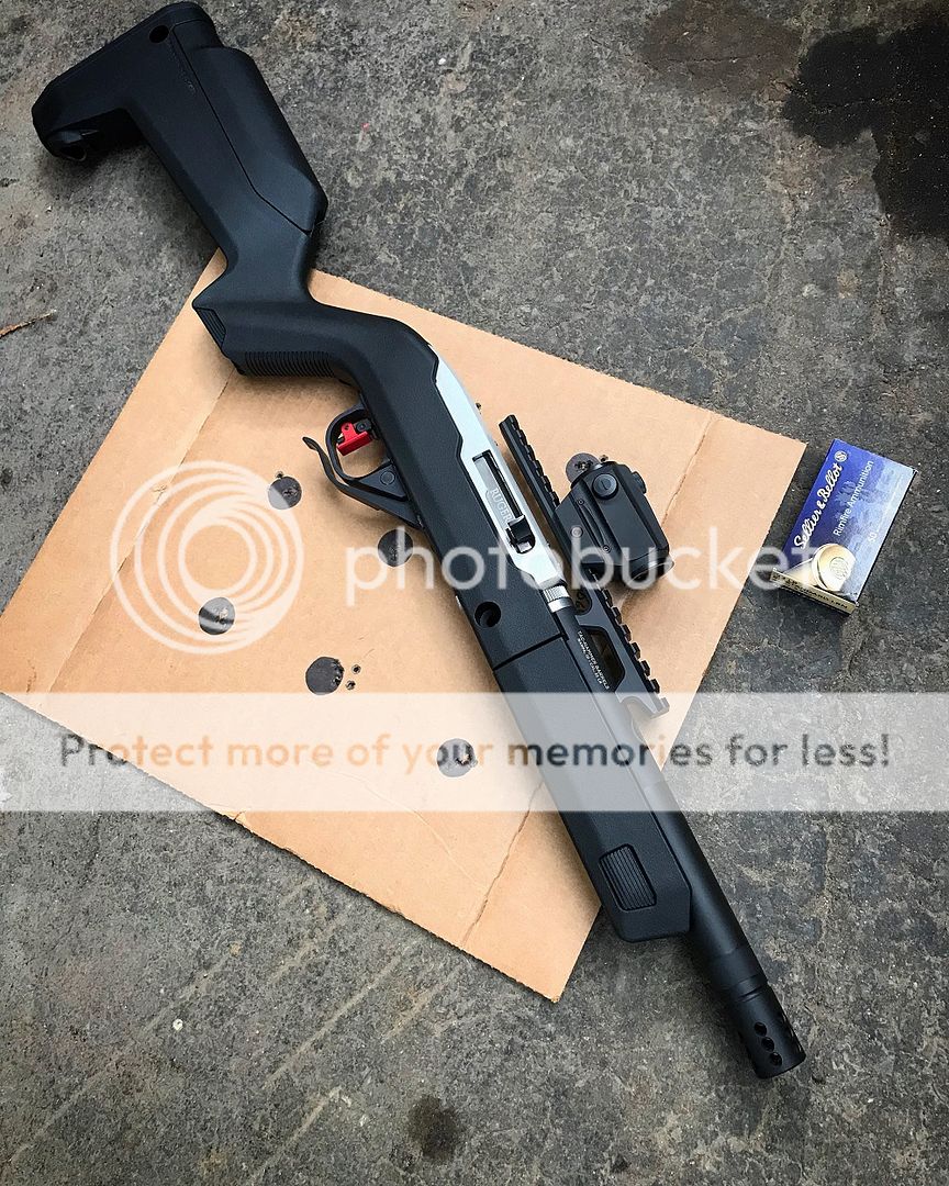

Got out today after putting together this fun little build, its my first takedown, I am definitely more of a bolt action guy but in this case a semi appealed to me. It was intended at a little small game woods gun so accuracy wasn't the first thing i had in mind but im very pleased with the way it handles and shoots. I only had time to test it with S&B standard 40gr LRN but they seemed to do fairly well out of it at 30 yards off bags. i think i may put a magnified optic on it to see what it shoots like at 50 yards. keep in mind the red dot is 2MOA and a 30 yards all but covers the black dots.

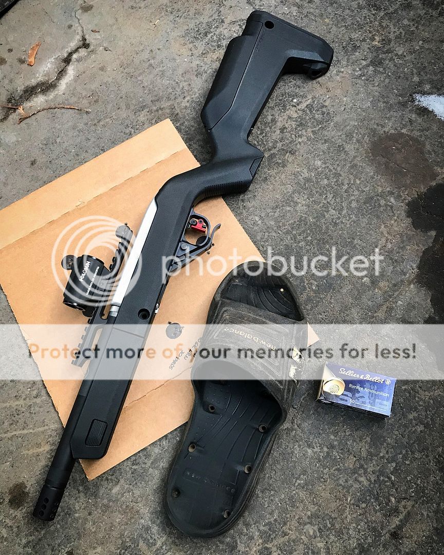

i had to put my shop sandals in there for a size comparison

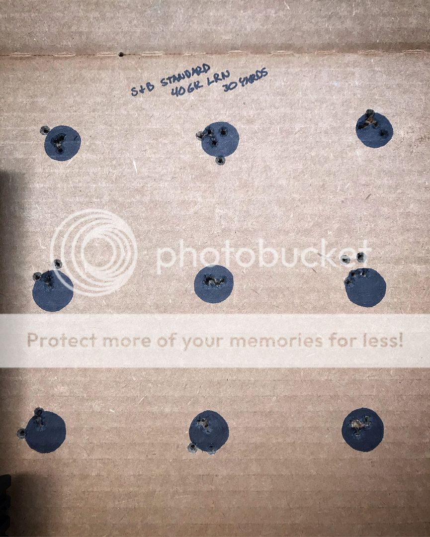

all groups were shot at 30 yards, 5 shot groups and all are under .75" some measuring well under that. the trigger likely makes the biggest difference but im very pleased with the results thus for for a 9" barreled fun .22

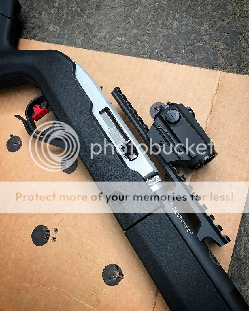

Parts:
ruger receiver and bolt group
timney tigger group
magpul backpacker stock
adaptive tactical tac-hammer 9" barrel
holosun 2MOA micro
