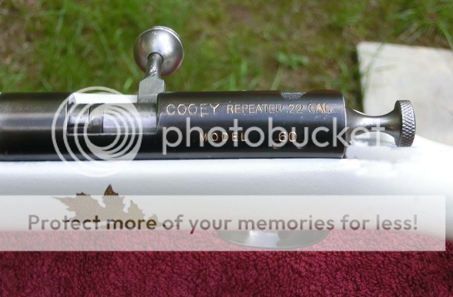

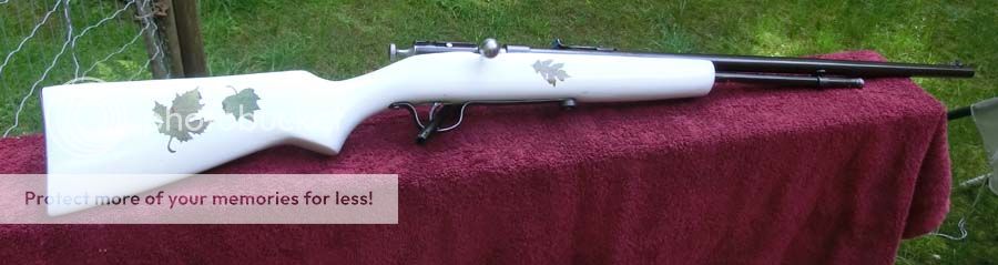

I picked up a very sorry Cooey 60 a while back. The stock was shattered, no bolt and rust was it's hue. I didn't have any spare stocks so I cut out some of the trash, laminated some hardwood strips and glued it back together. It looked pretty crappy but it was solid.

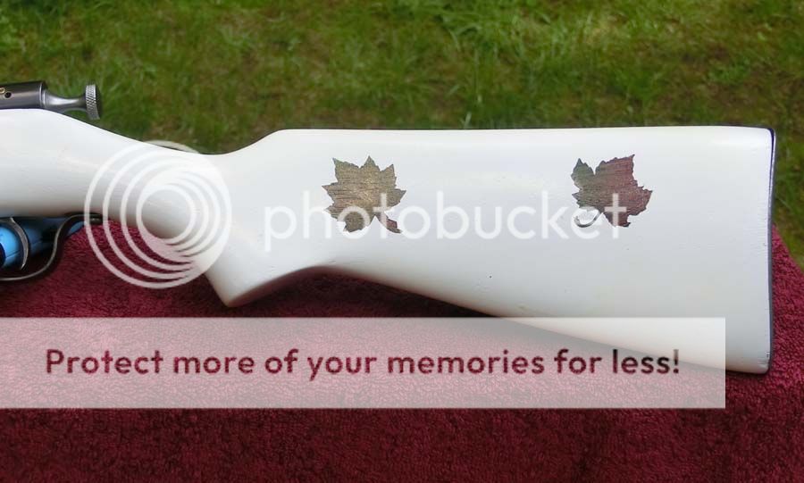

I then sanded and stained it. Next step was to very lightly spray some fine mist of green and yellow. Just enough to get a hint of colour. I applied some leaf shaped patternes and sprayed the whole thing white. Removed the patterns, light sanding then several coats of clear coat. The leaf patterns have the fall colours and the wood grain still shows through.
I buffed the metal and did a cold blue with Brownells liquid and 000 steel wool.
All in all, I like the result.
Took it to the range and it did 1/2" @ 25 meters. (My buudy did that. My eyes aren't that good.)
