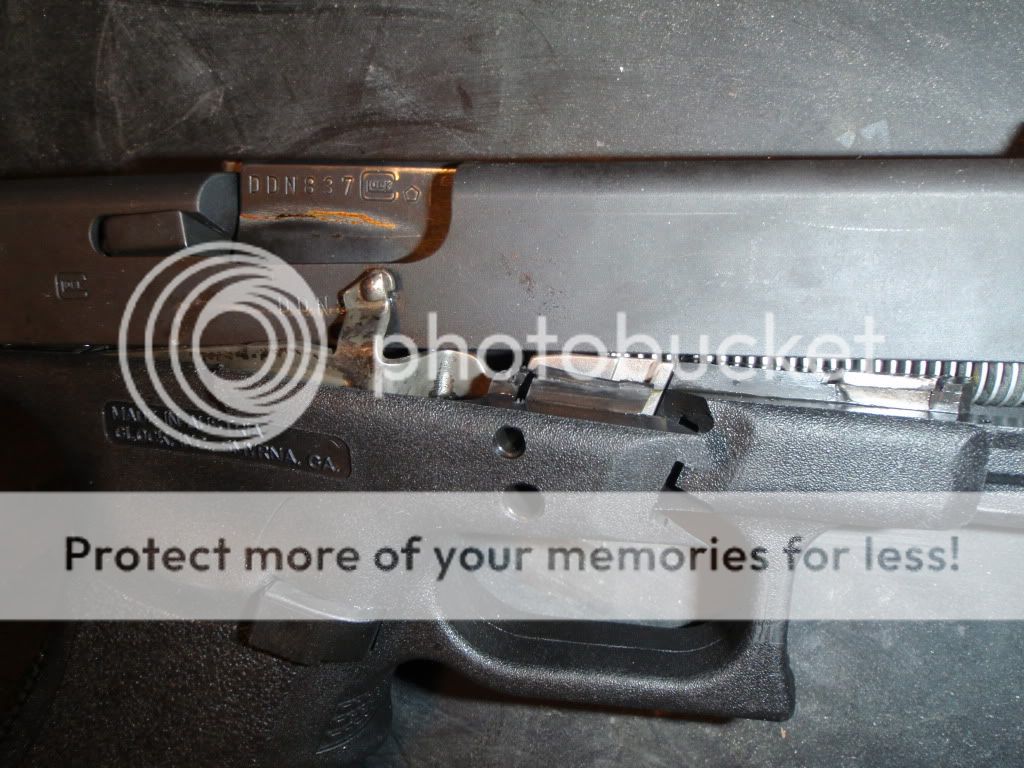

I learned the "don't trust anyone elses handloads" the hard way. Cost me my G21.

There is nothing amusing about this subject just plain ignorant individuals that have no real clue what chances they are taking but it will effect us all eventually if not stopped. I don't find jamiejef's pic very funny and just pray he was not hurt.
