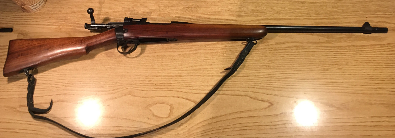

Hello. I just inherited this nice old rifle. It’s in fantastic condition and virtually looks unfired. From what I can figure out its a Savage made rifle for England in 1942, but no property of the US on it. A flaming bomb is stamped here and there. Bolt head is stamped 2 and handle serial #matches the receiver.
Thanks in advance for any information offered
Cheers
That's a nice one. Early 42 and Mk1 rather than 1*. Not rare but not common either. US ordnance mark for lend lease. Good candidate for a restor. pm me if you need help. I am out in Mission.
Yup, it's got the early cocking piece as well. I don't know if those were replaced during ftr processes or there just weren't a lot of them put on.

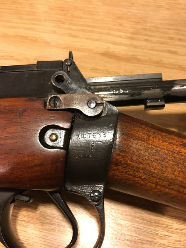

If you look closely at the receiver, just above the model marks in the third photo you can see the grinder marks where the "US Property" stamp was ground out. Some people say this was done purposely in some depots but who really knows.

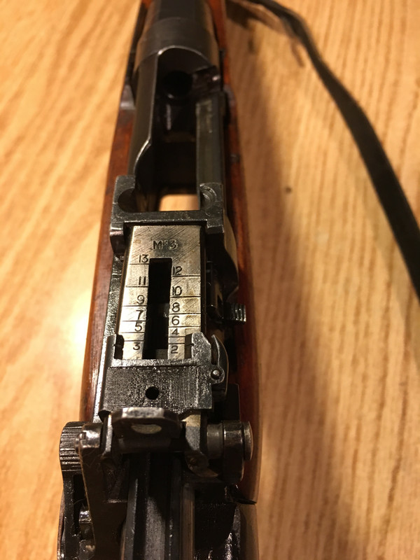

That mkIII rear sight might have been installed during an ftr as well. It may also be original.
TURF THE LIBERALS IN 2019
Yes I see what you mean. Looks like (US) in cartouche. I’d never have seen that!!thanks for the info and offers. It’s the only Lee Enfield type rifle I have and would love to have a desporterized example as a milsurp
Well, this one is definitely worth restoring to original condition.
Of the million rifles built by Savage, this is only Number 7633: just 3/4 of 1% of the way into production. Unlikely you will find another one that early, still in this kind of condition.
When you "desporterise" the critter, do hang onto the wood which you remove; that was how someone close to you liked it. Besides, it's less weight if you want to hunt with it!

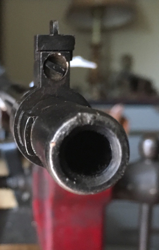

emmab : Apparently Savage had their own unique metal finish (Du-lite, a type of parkerizing?) and yours looks like it might be original. Definitely worth putting in a new forend. If you've never done it before (and want to try) study up on a forum like "milsurps" as it is different from any other type of rifle. I have a much rougher Savage a few thousand earlier than yours that also had the US Property mark ground off at some point. Check the bore on yours and count the grooves- you might have a 6 groove barrel, something Savage used in their early production.
milsurpo

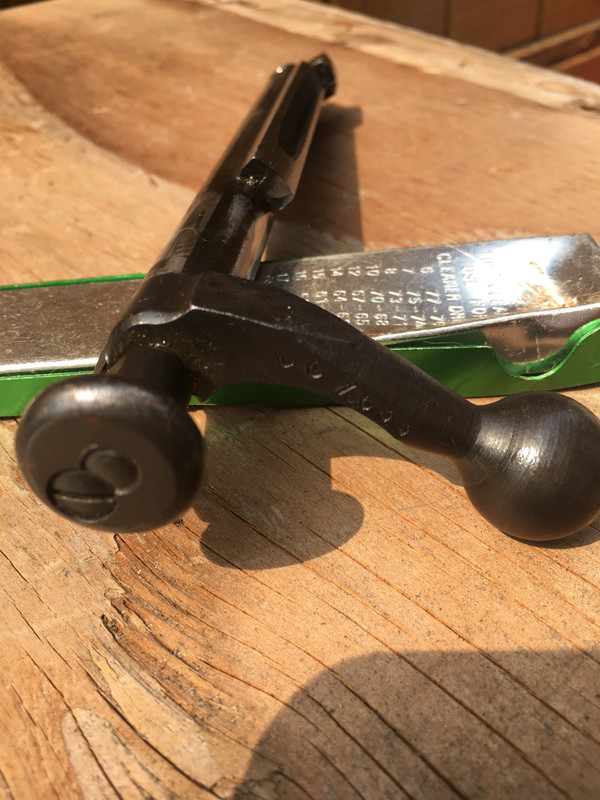

Nice looking no.4 sporter, as other have said it’s a good candidate to restore. That being said it’s a nice looking sporter, I have a soft spot for them. The 43 lonbranch I bought with the intention of desporterising a couple years ago had so much character when I cleaned it up that I decided to leave it as is and hunt with it, which is likely why someone sporterized it in the first place. It’s a joy to carry around the woods and it shoots straight, I took two whitetail with it last year.
Off hand I think it’s 6 left. Looking at the muzzle it looks like a hexagon where the grooves are. The rifling looks new but the end of the barrel over the crown has some dings. Yes it’s a very nice looking hunting gun but I’ve got lots of those. I’m sure the rifle is very strong. How it shoots is another question.
Here’s a few bolt pics

That little ding on the crown is just a character mark. Shouldn't hurt anything.

Your barrel is fine, bayonet lugs and all.

I was wondering how I can tell how many grooves the rifling has? I just looked at the muzzle and assumed 6 from the hex pattern on the end of bbl.
