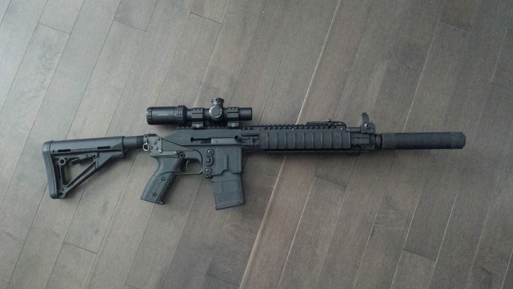

@ little_airwolf: Nice thing about the CASV-M is that all you need to do is undo 2 screws and the whole system slide off in one piece. The added bonus is you don't have to remove your optics so you don't lose your zero, well, as long as you re-mount it exactly where it was before. This rig as it is has proven to be dead accurate at 100 yards.

The CASV-M should clear it no prob. There's enough of an angle at the front of the stock pieces that it shouldn't interfere. It goes together kind of like a clam-shell, just loosen off the two screw at the back where the hinge pieces are and pinch the pressure tabs together at the front and it swings open. The rail piece itself has a side angled piece like picatinny rings that tightens onto the existing receiver rail with two screws so the whole install would be pretty simple.
The only cutting I did was to make notch big enough in the bottom rear of the stock to clear the chamber area. After that the whole barrel assembly is completely free-floated.
