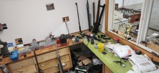

You have apparently never seen a messy shop.
That's the clean part.

Here's the messy part.
