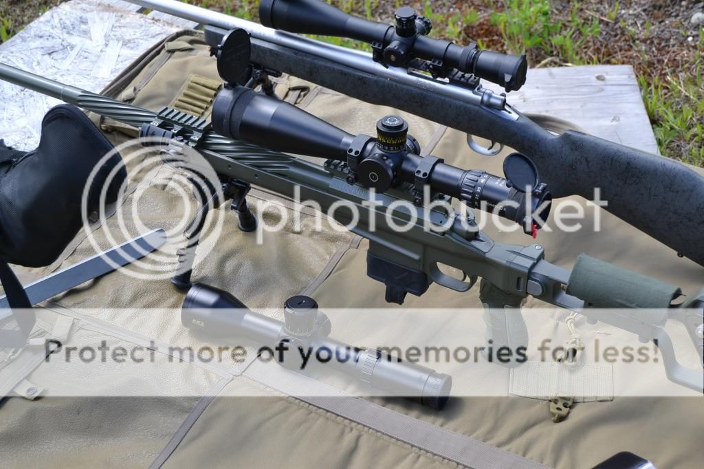

To made side-side observations I brought along the S+B as well as a NF NXS and a Leupold Mk4 8.5-25x50

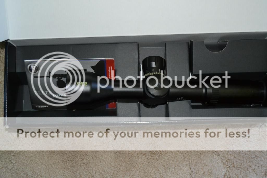

Packaging/Instructions: To some it doesn't matter, but for me I appreciate good packaging and this scope was nicely packaged in a sturdy box and came with well-written instructions in the real English language. No sunshade or accessories were provided however and no nice lens cloth was to be found either.

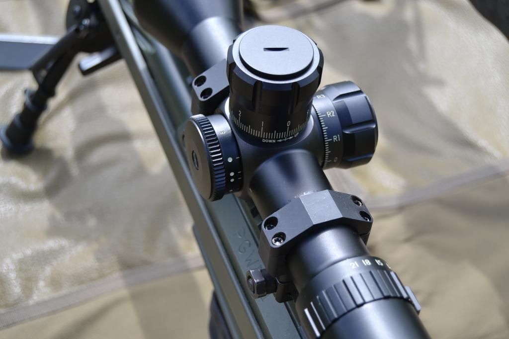

Controls/Ergonomics: In my opinion there are two things that are critically important about controls - they have to be repeatable (any scope that fails this test simply cannot be relied upon) and they have to have a good 'feel'. Perhaps the only criticism of my S+B scopes is that sometimes, and especially with gloves on, it easy to put on a few clicks to much in making a windage adjustment but not so with this Bushnell - the controls were easy and precise to use with good tactile feedback and, yes of course, it passed the box test. I also am pleased to say that the numbers on the turrets were easy for me to see as were the numbers on the magnification dial - these kind of things are important to me especially on a scope this pricey. What was more difficult for me to tell what revolution of the turret I was on when the turret was locked - sure, I could work it out but it wasn't as clear to me as the DT Turret on the S+B (which turns bright yellow on the second revolution) or the turrets on my NF NXS. I know this sounds like I am being 'picky' but my at this price point it is fair to be demanding. Big plus for the 10 mils per revolution on this model as also for the zero stop feature.
