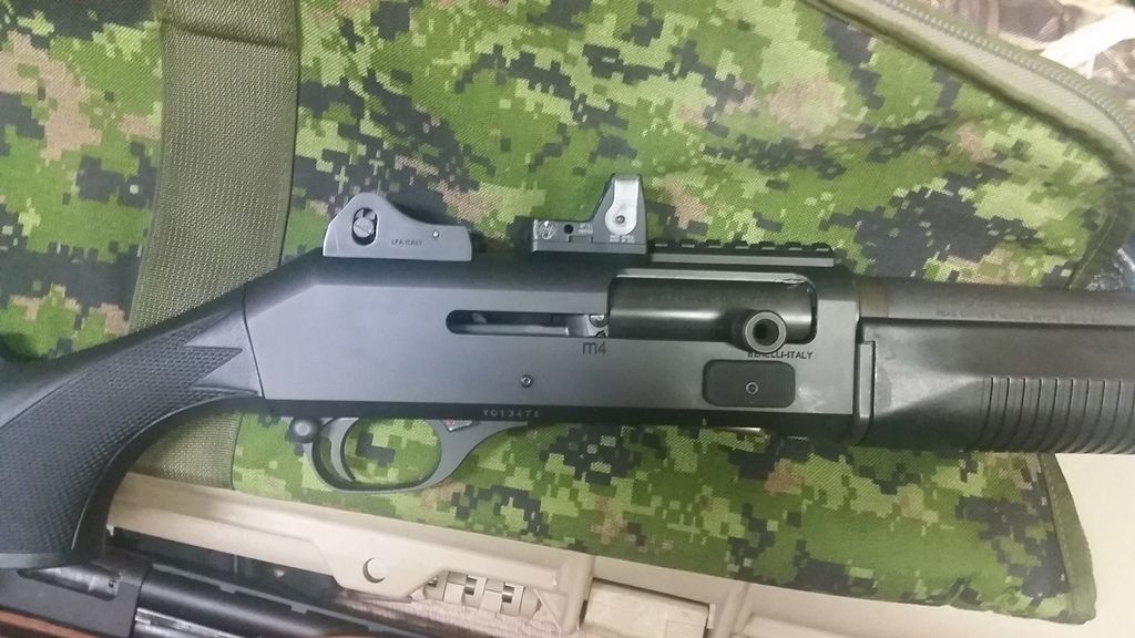

Don't bother with the B&T rail - it's heavy and not as comfy as the stock fore-end. How much stuff other than a light will you realistically put on the shotgun? Vert grips/AFG blows chunks, and not like you need a bipod or other crap.
Also - the large carrier release IS worth the cash. Oh and the Field (traditional style) stock is also fantastic - never been a fan of the Benelli pistol grips.
The Scalarworx RMR rail allows an RMR to co-witness - it's THE best optic solution for the Benelli M4. Without a doubt.
