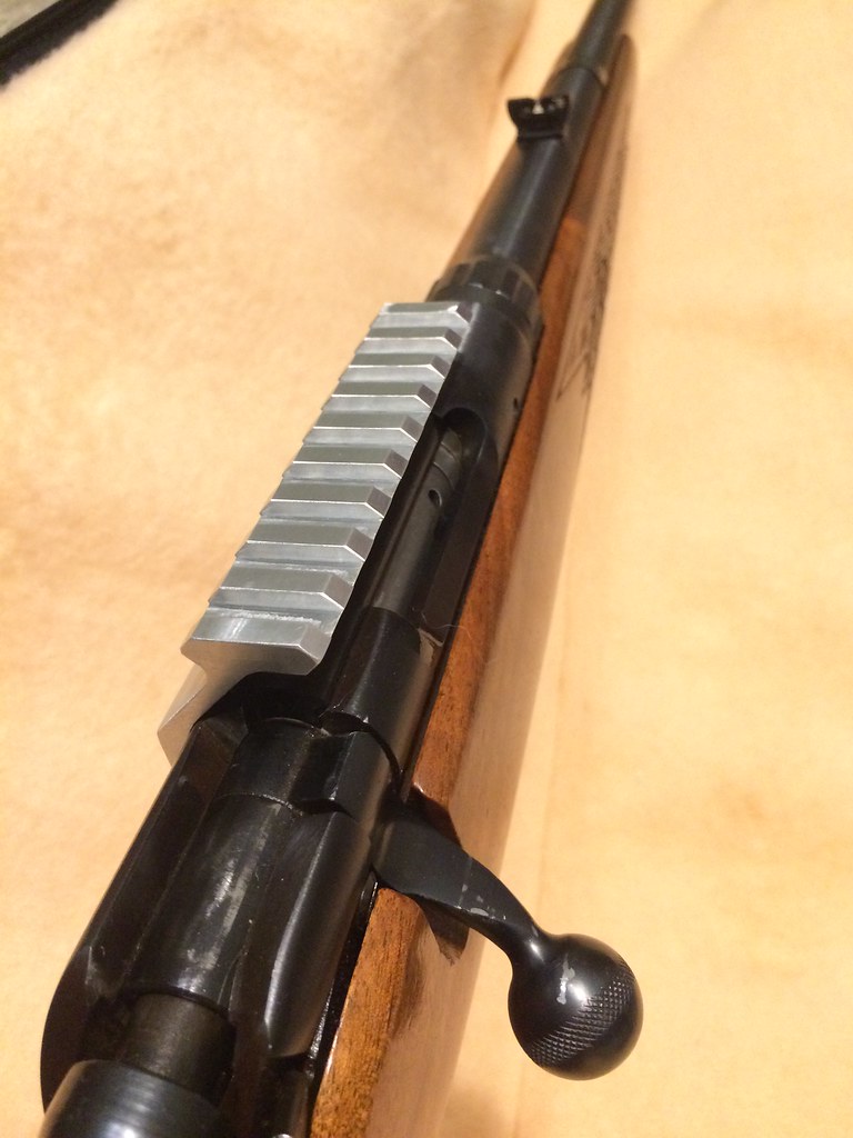

I got to do an interesting project the other day...
One of my customers has been trying to track down a scope mount/rail for his Savage 340 without success. (I know they exist, he couldn't find what he was looking for)
so... we built one!
A little bit of artistic design in CAD...

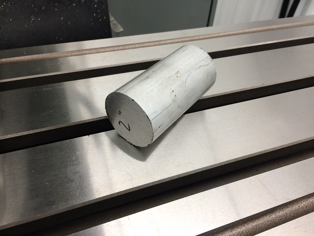

A nugget of 6061 about to go on a diet...
Let the mess making begin!
Some finer details to bring this thing to life...
And he should be off to the races!
And there you have it! Sometimes its easier to just make it and be done...

This one was going on a .22Hornet so I used aluminum to keep weight down (knowing recoil wouldn’t be an issue)
Let me know if yould prefer steel over aluminum and we’ll go from there.

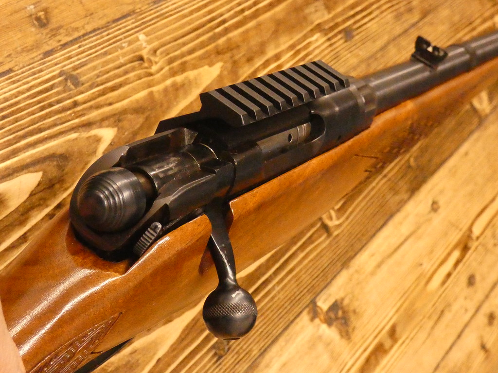

Been making chips!
It took some new planning to be able to make these more efficiently (the first one-off was about 6 setups in the vise, dialing and picking up zero every time).
This way I'm making these two at a time, back to back(obviously) and all in one set up.
Just givin'er!
Ready to split/face to length.
There's a lot of material that comes off of these!
And there isn't ton of clamping options once they're profiled so I built a fixture that permits cutting and facing.
More to come!...
First batch is blued and ready to go!
