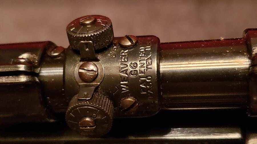

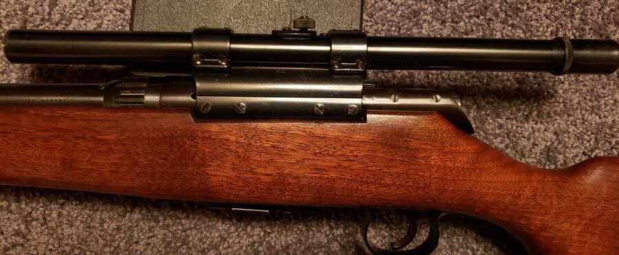

I need one of these for my Grandfather's old Savage 342 in 22 Hornet! It has one of those old 7/8 th inch horrible Weaver scopes on it!
Will it fit the 342?

Ok, my calipers kinda suck, but this is what I could get from them for my model 342.
A = 14.68 mm +/- 0.10 ish
B = 38.40 mm +/- 0.10 ish
C = 14.46 mm +/- 0.10 ish
ID of hole is 3.58 mm +/- 0.10 mm
Yep, that should work.
