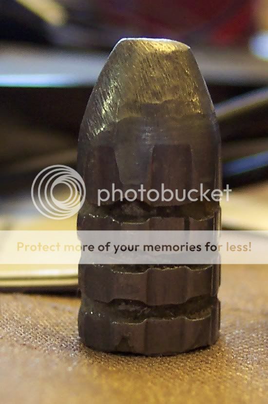

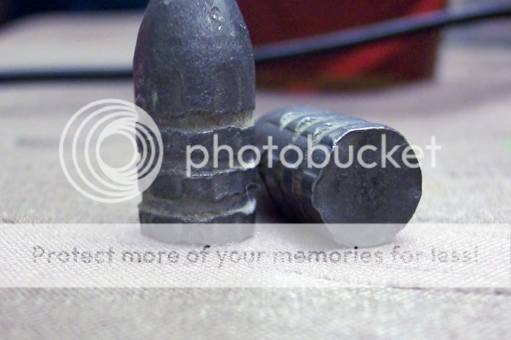

Some of my recovered boolits
Great pics that show just how high the lands are on the bores of these old girls - makes the bullet look hexagonal.
