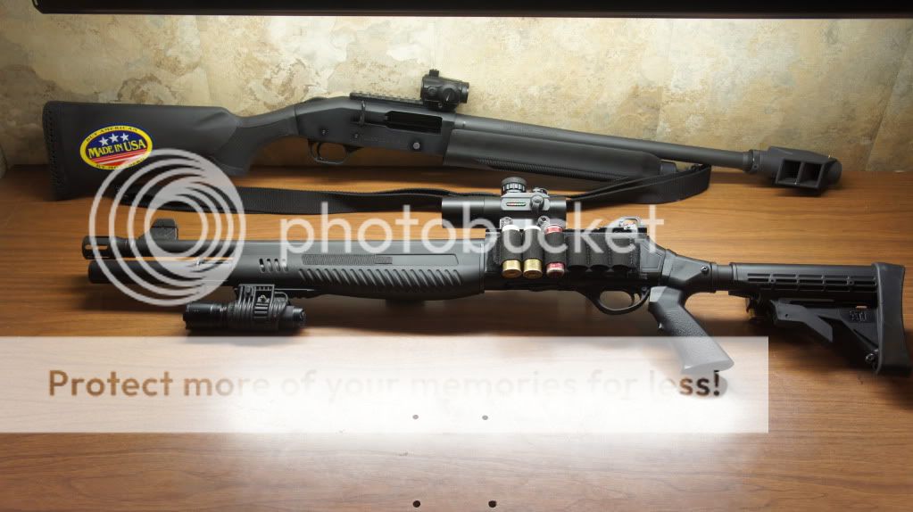

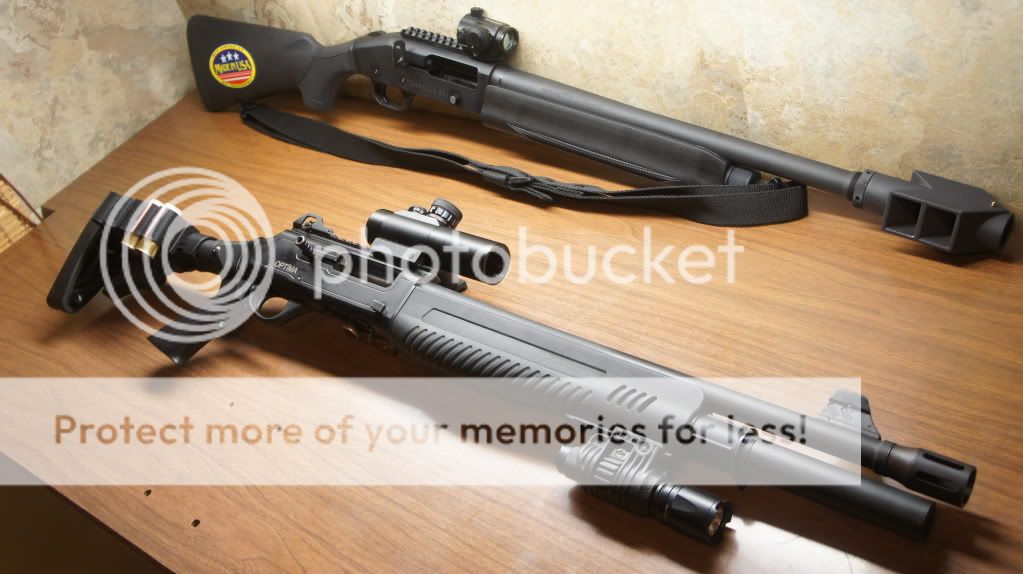

Just got my Hatsan optima mp-a and I'm wondering if anybody's done any mods to theirs and if so what parts did you use ( 870,500) and from where? (ie shell carriers , stocks , etc)

Cool man. How is the stock or recoil? The stock one kicked my a$$. Did it just bolt on or was there alterations reqd? Was it for an 870?

Maybe lots more practice ? The round count on my MP-A is over 8000.
The ATI stock came with an 870 and 1100 adapter.
I used the 1100 and filed it till it fit.
The bolt that the holds the stock to the receiver needed to be replaced and cut down.
Your video aint working. And I meant that it beat my shoulder up. I was shootin a bunch of slugs through it bc the Winchester 1180fps target loads didn't have enough punch to cycle the bolt properly but the 1200's did. I'm just wondering of your stock provides a softer recoil than the factory one does. I wonder if I could make the Knoxx fit?
